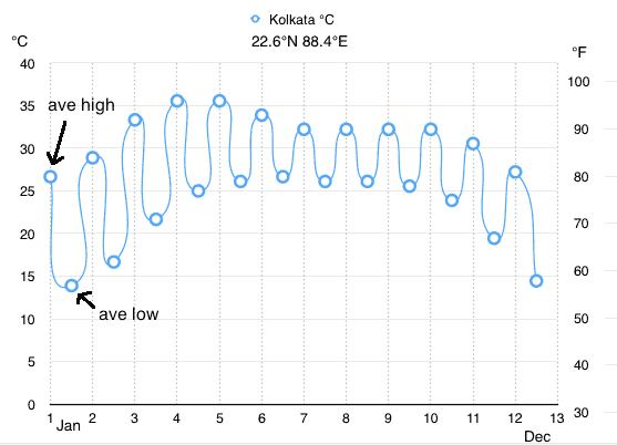

That's an awful lot of run time for an electric resistance heater. Do you have the option to use a fuel-fired heater or heat pump? Either would be much, much cheaper to run. At my electricity rates, that would cost $115 / yr .
...or how about better insulation? Given the room size and outside air temperature, I would have expected it to need very little heat.

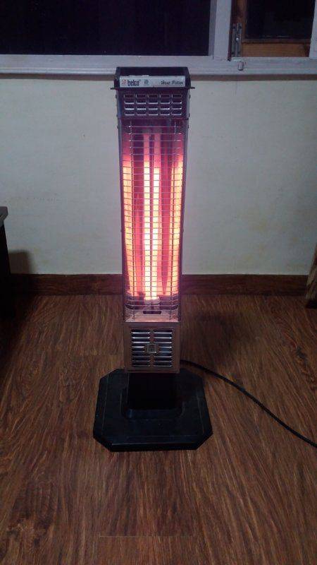

Here is one of those types:
And one from Amazon.in:

Wow! 27°C during the day?
Too bad you can't just leave a window open during the day, and shut it at night.
OK, never knew they are halogen based (their name here doesn't reflect the construction, and I was always under impression they use just an inert gas inside of the quartz tube, not a wolfram coil in a halogen mixture). Makes a bit of sense, at the same time I would expect them to have shorter life span. But that's just a gut feeling.

That Halogen heater in your photo will yield more of spot heating from radiant energy. These are good for colder ambient temperatures where you want to warm yourself but don't want to heat the whole room.
The lower temperature bare resistance element types, especially those with vents or a fan for air circulation, are better for heating a whole room; not so much of a 'hot spot' when you walk in front of it.
Heating the whole room will be more comfortable but cost a bit more in electricity.
