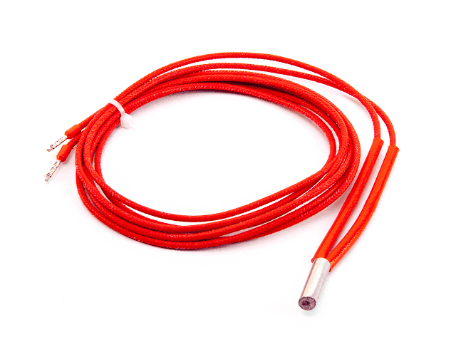

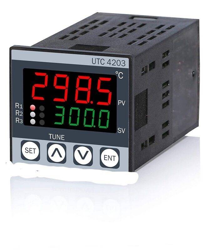

Dear friends, I am in a search of a temperature controller for 12V, 40W ceramic cartridge heater! I can not change the heater because of my application. I want to purchase a simple PID temperature controller available in the market. But I am not sure whether they can provide me the 12V output. And I also don't know which relay I should connect. Again that relay should be cheap. Can I use simple 12V relay which we use with arduino with such temperature controllers? Please help me with this. I am irritated because, I am not able to find anyone who has used 12V heater with temperature controllers of such. I am talking about these kind of temperature controllers.

I want to make a small hotplate. It's okay for short life time because I am trying this for a first time. I will drill a hole in small aluminium block and try to heat it. 1° accuracy will be okay for my project. I am having same heater provided in the link above and I want to have a temperature controller for it.
Any help will be appreciated a lot.
Your 12 V 40 W cartridge heater draws 40/12 = 3.3 amps. You need to provide a 12V power supply rated for a little more than 3.3 amps. The heater works exactly the same with either AC or DC power. A good choice would be a 12 volt transformer rated at 5 amps.
The temperature controller has a relay output rated 230 volts and 5 amps. Since your heater needs only 12 volts and 3.3 amps, the internal relay in the temperature controller should work nicely. Just connect the transformer to the temperature controller relay to the cartridge heater.
This temperature controller has two relay outputs. Make sure you connect to the correct relay. The other one is rated for only 50 ma (0.05 amps), so would be destroyed if you tried to use it.
Make sure that your temperature sensor is close to the heater. If it's too far away, control will be poor because the temperature will oscillate between too low and too high. I suggest inserting the temperature sensor in a hole about 2 or 3 mm from the hole for the cartridge heater.

Yes, It is working. For that you will require one temperature controller, one SSR and an Transformer(as per your cartridge heater - For 12V cartridge heater a step down transformer of 12V with 5Amps current rating will be sufficient). Wiring is pretty simple.
