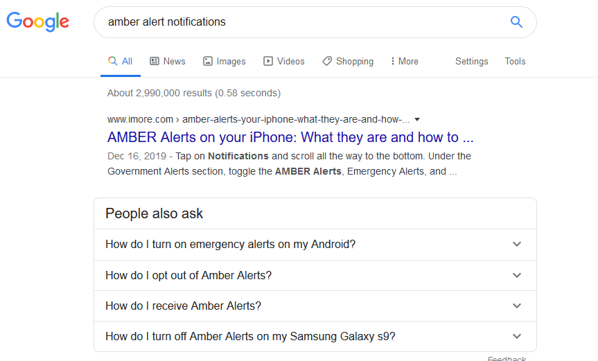

I used to get Amber Alerts as part of my EMS PulsePoint push notifications, but they were way too obnoxious, so I turned them off. I'm not sure where I did that (In PulsePoint, in my local county Alerts [Alameda County, Santa Clara County], etc.?) I'll check to see if I can see what I turned off...
Nothing under my PulsePoint settings, but there look to be lots of links via a Google search. Have you sorted through all of these already? (probably yes)
https://www.google.com/search?client=firefox-b-1-d&q=amber+alert+notifications
