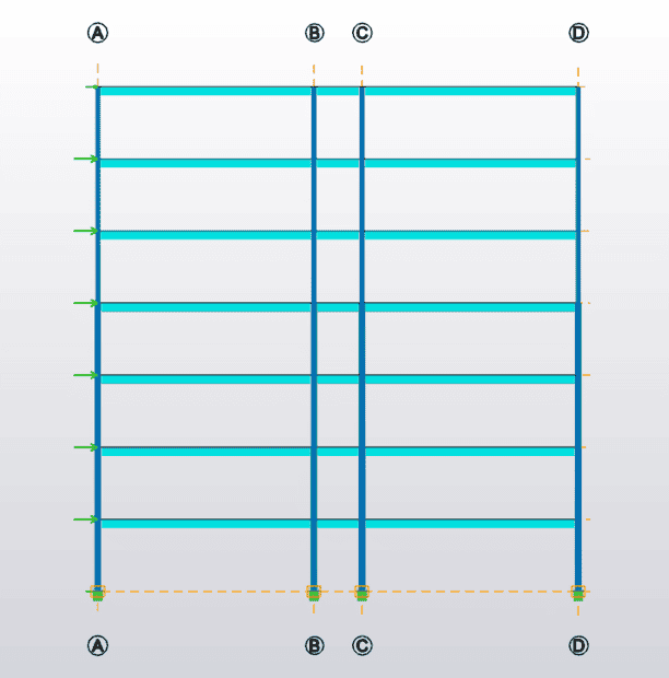

I was wondering if someone might know why I am getting incorrect signs for my structure that I am working on using the Direct Stiffness Method? I am following the procedure that I was taught when I was at University and I can't completely remember everything. I am designing a seven-storey structure that looks like this:
The magnitude of the forces I am getting is accurate, but the signs are incorrect.

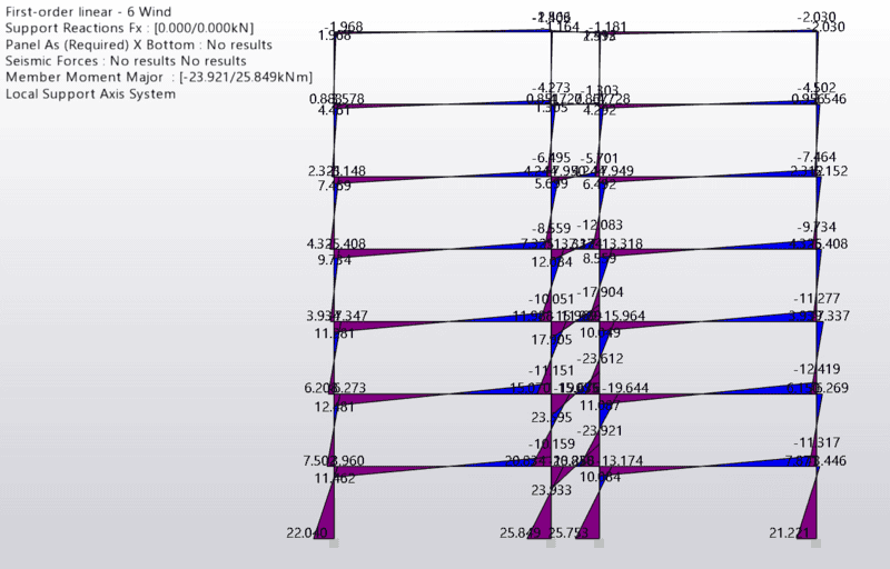

Here are the bending moment on the structure:
You might not be able to see, but for the columns, you get a positive bending moment at the bottom of each storey and a negative bending moment at the top of the storey - this pattern is the same for each storey.
In my code I am getting positive bending moments at the top and the bottom, but like I said the magnitude is quite accurate.

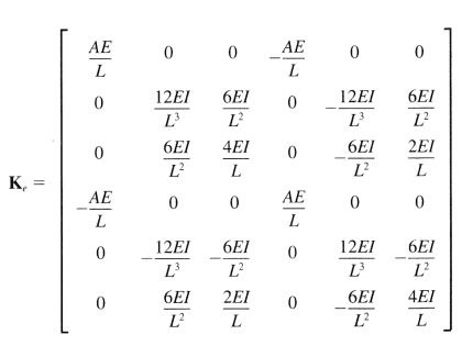

The local stiffness matrix for a column has the form:

I guess the thing to look at is the transformation matrix. Does it seem correct to you. The local stiffness matrix is definitely correct.

I am applying horizontal loads at the joints from left to right. The top load is 3.3 kN, the rest are 6.6 kN. The frame is a rigid frame with rigid joints, the bottom columns are fully fixed.
Purple is positive and blue is negative for the bending moments. Yes right is positive for the x axis and upward positive for the y axis.
The columns and beams bend in double curvature due to the shear. Thus, I should be getting a positive and negative bending moment at the column ends (that is what the software is giving me). However, I am getting positive bending moments at the top and bottom ends of the columns (using the stiffness method in MATLAB.

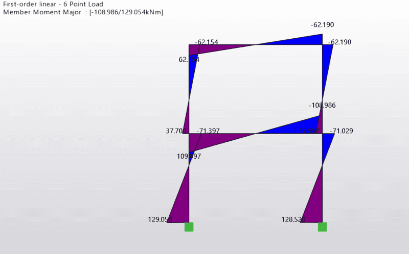

Here are the results from the software:
Bending moment diagram of a two-bay, two-storey portal frame with base supports, showing moment values in kNm on each member with filled purple and blue shading; values include -62.190, -62.154, -108.986, -71.397, -71.029, 129.054 and 128.52.
I don't know why this is happening!

Element 1 is the lower left column. Its first node (with dofs no 1,2,3) is attached to the ground, its second node is the top one (with dofs no 4,5,6) connecting to the rest of the structure. What you've calculated in the table at the end of the code is the forces on this element in the local coordinates (i.e. positive axial is upwards, positive shear is to the left, positive rotation is ccw)
On node 2 of element 1 there is a horizontal force to the right (i.e. negative shear from the element's perspective). So on node 1 there needs to be a positive moment (i.e. ccw) to compensate for this force. Which is indeed what you calculate.
If the column was not attached to anything else, the column would just bent and the direction normal to the column would be somewhat downward. Due to the rest of the structure (horizontal beam 5, and vertical beam 3) this is however not possible and you need to apply another positive moment to bent the beam 'back' to vertical.
In other words, you indeed get two positive moments on the nodes. You can apply the same reasoning to all other columns and beams.

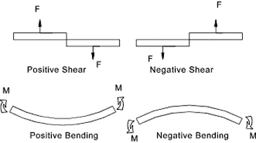

So, what about the software? Well, maybe it defines this as positive:
Sign convention diagram with four panels: positive shear and negative shear show two offset beam sections with opposing F arrows; positive bending and negative bending show curved beams loaded by M moment arrows at each end.
Note that the positive direction of the moments now switch sign at each of the nodes, and with this definition you would indeed have a negative moment at node 2 of element 1. This would be consistent with the results of your software.

You are absolutely right, and the answer to the whole dilema is a very simple one: The direct stiffness results are the applied moments to the end of the member the internal moment, the plotted moment diagram from tekla (The software), comes from the application of statics/mechanics along the length of the member (Celt83, Eng Tips).
Therefore, there is one more step after retrieving the results from the Direct Stiffness Method, where you simply apply the mechanics/statics to the joint translations/rotations found, and then you will get the internal member data - this is what the software is displaying.
Furthermore, just draw a free-body diagram of one of the members with the results obtained from the DSM and find the bending moment diagram - it will give you a positive and negative bending moments at each end.
