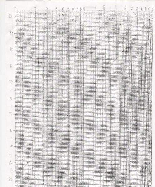

i have some data and i have to find out if they can be put in the function f(x)=a^x or f(x)=x^a
it is about how much time there goes before the population soemwhere grows or such.
data: it is about the growth or a population in a villlage (way hard to explain)
time data: 15,59, 146,362, 571, 900
population; 72,69,67,65,64,63
addition: see the attachments. the red apaper is the doublelogarithm paper where i have put my data, and the grey is the single logarithm where i have put my data...but as you see the lines are both straight which is the problem
then i have been thinking that u can actually just draw it and see if it makes a stright line in a double or single logarithm paper. and where it makes the stright line must be that funktion, but when i did draw it turned out to be stright in both the single logarithm paper and the double logarithm paper ...that is the reason why i need help...because i know it should only be stright in one of them yet it turned out to be in both
i hope that someone will help me

1) Your plots seem to show only 3 points, but you have 6 data points.
2) Change the scale on the second plot's x-axis, to spread it out better.
3) When I plot your data in Maple I get a straight line only for a log-log plot. The semi-log and direct plots are decidedly nonlinear.

When I say "second one" I mean the orange plot. By 'spreading out', I mean re-scale time to something like 1.5, 5.9, 14.6, 36.2, 57.1, 90.0, so that your time values are not so squeezed together on the graph.
I suppose you did the gray (single log) plot incorrectly, but I cannot see how because the picture quality so poor. All I can tell you is what I got.

firstly you said to change the scale on the second plot's x-axis, and now you say to change the time but i have the time on the y-axis ?it is like f(population)=... so my x is the population
Besides how can a person rescale the time on a log axis
and i did rescale on the single logarithm paper and for me that line seems really very straight...it's the one that was in poor quality before and now i have added a new version with this massage..so if you would take a look on it please
"When I plot your data in Maple I get a straight line only for a log-log plot. The semi-log and direct plots are decidedly nonlinear." when you wrote this i didn't get what log-log is ? do you mean you only get a straight line on the orange?
Log-log paper has logarithmic scales on both axes. Semilog paper has a log scale only on the vertical axis.

I don't see how you got the plot that you show in post #8 from this data. The graph you show is a straight line (on log-log paper) with a positive slope, but your data shows that as time increases, the population is decreasing.

Its's easy: take logs of 1.5, 5.9, ... instead of 15, 59, ... which is exactly what I said already.
Sorry: that may be a bit confusing; x and y axes are standard terminology. The x-axis is the horizontal one and the y-axis is the vertical. For example, I may plot volume versus pressure, with pressure (P) on the x-axis and volume (V) on the y-axis. You will see that type of description over and over and over again as you continue your studies.
Anyway, the plots I did were: semilog (plot of population vs. log(T) with log(T) on the x-axis), and log-log (plot of log(population) vs. log(T), with log(T) on the x-axis).

I don't see how you got the plot that you show in post #8 from this data. The graph you show is a straight line (on log-log paper)the attachment i put in 8# wasn't log log paper but semilog...there is only a log scale on the vertical axis with a positive slopeit is not with a positive slope ...you see it like positive because therotated...look closely at the numbers ...by the way sorry couse i put it in rotated , but your data shows that as time increases, the population is decreasing.
And the thing about that attachment is that everyone here says that my data can only make a straight line on a log-log paper, but how come it also turns straight on a semilog when i put them...see the last attachment again
Besides i think i didn't really say it correctly what i am trying to do...but the teacher told that we can put the data on a normal paper, on a semi log and on a log-log and see which of the papers craetes a straight line...he said that we shouldn't take the log or anything of the numbers...just put them...and the time should be on the y-axis
Anytime you make a plot with scaling set so that either the horizontal component of the data are very compressed or the vertical component of the data are very compressed, the result will be either a nearly horizontal line, or a nearly vertical line.

The image in post #8 is not good enough to be able to read the coordinates of the points. In any case, as I said before, you should not be getting a line with a positive slope.

The 15 in your time data should be paired with the 72 in your population data, and so on. Are you getting the order reversed?

Sorry: my description is incorrect. The semilog plot has T on the x-axis and log(P) on the y-axis, while the log-log plot has log(T) on the x-axis and log(P) on the y-axis.

But it isn't positive slope ...I do not get a negative slope you just see it as positive because the picture on #8 is a bit upside down like 90 degreees to the left
what do you mean with getting it reversed? i did exactly as you are saying, but but it is going to kill me since iv'e used like three day and when i put my data in a exponential function they also are right and everything...the only problem is that my line in the log-log paper also is a straight line and i may not have two straight lines
Well, that explains why the slope appears to be positive. The image quality is so poor and the axes are not labelled, so I was not able to see this.
