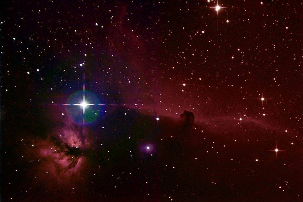

I've noticed that a lot of these pictures are like this. Is it something to do with the error in the machining of the lenses?
Astronomy news on Phys.org
They are diffraction spikes created by the internal support structure of some telescopes. Some astronomers who don't have such telescopes even tape wires overtop of the scope for artistic flair: :cool:

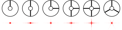

Are there strong technical reasons why a telescope should have 4 rather than 6 diffraction rays?

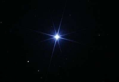

Depends on the number of supports for the secondary mirror and the brightness of the star
here's one with 8 spikes
generally refractors and reflectors like Schmitt Cassigrain's don't have spikes
because there are no or no need for supporting vanes
If we talk about reflecting telescopes, for a particular design you could have even 6 spikes. But most common is design with 4 spider vanes to support the secondary mirror, like in case of Newtonian reflector. Check this link for more details:

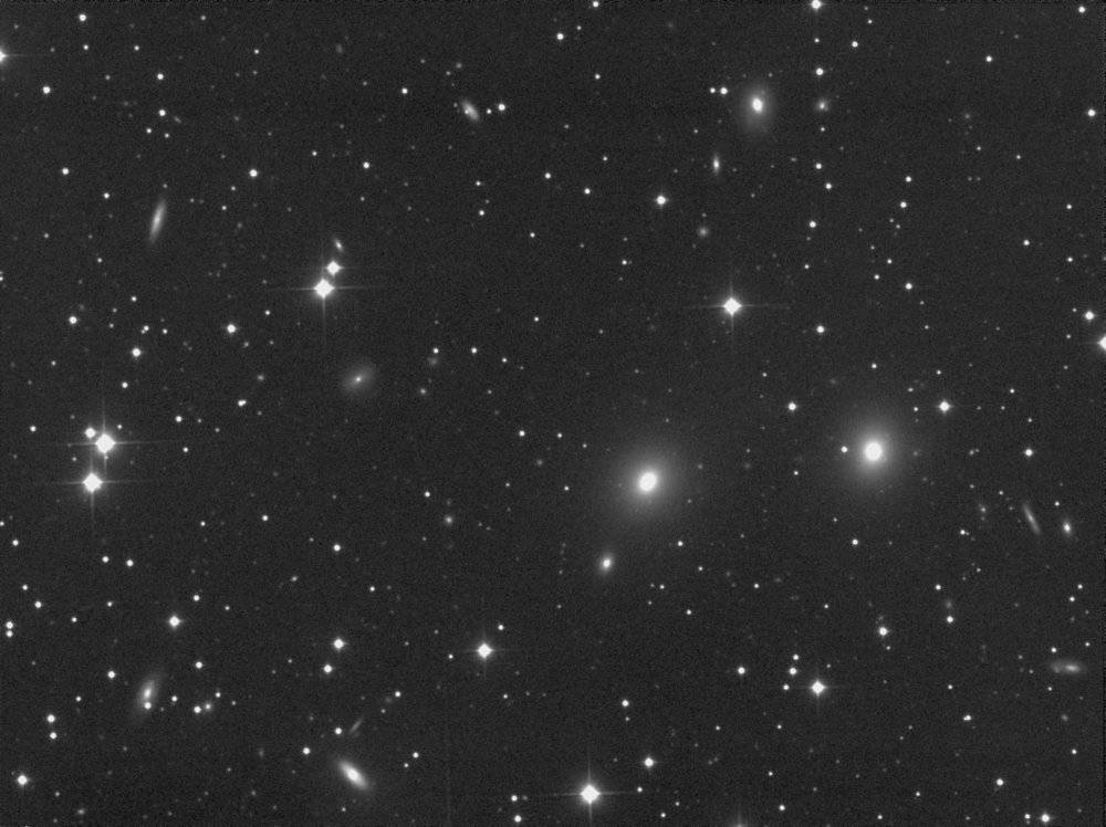

I think you're thinking of the very well defined, closeup, extended images of galaxies we are all familiar with. I'm referring to wide field images of clusters of galaxies like this one of NGC 7619 taken by astrophotographer Jim Burnell (jburnell.com) If you click on it you'll see two objects center right that are of similar brightness to some of the stars yet have no diffraction spikes - they are cluster members! Sorry for the confusion.
  • Love
I assume the galaxy in question is one of the bright images without the star pattern; it is a distributed source and the star pattern is therefore distributed and not visible.
Yes, exactly!

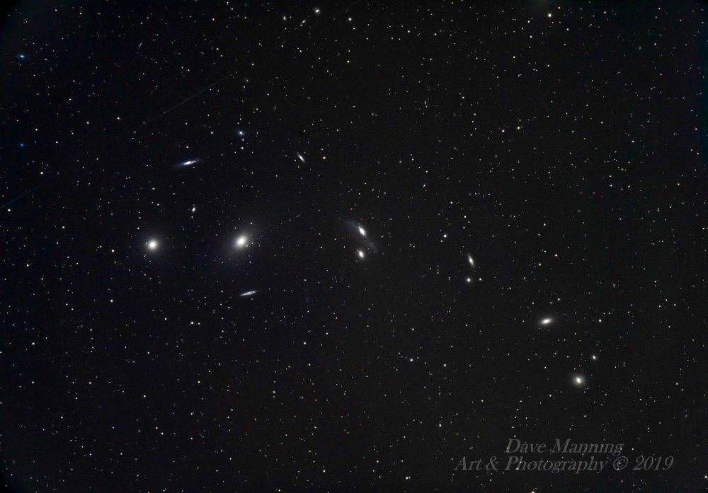

nice galaxy field ... will have to try and image that area ... it's gets above my horizon in mid August for a few months
A lot of guys in my area are imaging the Virgo cluster area at present ... M84, M86, M87 and a huge mass of others
Markarian's Chain of galaxies
By Dave Manning,
Telescope - Skywatcher Esprit 120mm Triplet Refractor; Field Flattener; Camera – Sony a7r Mk2, 18 x 5 min lights
He and I and a few others get out for astrophotography sessions from time to time
Left to right across the centre ... M84, M86, NGC4438 (upper), NGC4435 (lower), NGC4461 (upper) NGC4458 (lower),
NGC4473, NGC4477 ... and many, many others in there including lots of very faint onesDave
