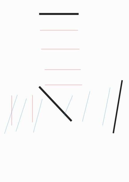

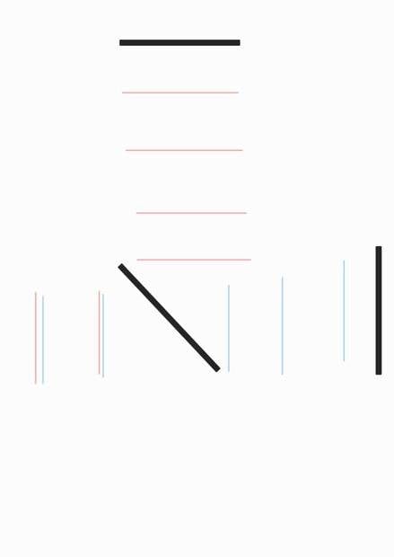

To get perfect constructive or destructive interference you set the mirrors up perpendicular to one another. I've sketched wavefronts coming back along both arms, red in one and blue in the other, and you can see that they're parallel in the output arm on the left. This would be near-perfect constructive interference since both arms' waves are in phase (give or take my lousy free-hand sketching) (edit: and that I got the 45° mirror on the wrong diagonal, as noticed by sophiecentaur below):
But the usual operating mode is to tilt one mirror very slightly (you're looking to displace one side of the mirror a couple of wavelengths, about ##1\mathrm{\mu m}##) so you get constructive interference in some parts of the field and not others:
It's much easier to use in this mode, so nobody sets it up in the first mode. But you can do it.

Ibix said:
To get perfect constructive or destructive interference you set the mirrors up perpendicular to one another. I've sketched wavefronts coming back along both arms, red in one and blue in the other, and you can see that they're parallel in the output arm on the left. This would be near-perfect constructive interference since both arms' waves are in phase (give or take my lousy free-hand sketching):
It's much easier to use on this mode, so nobody sets it up in the first mode. But you can do it.
Are you sure you've got the diagonal mirror the right way round?
It's... erm... reflected in... er... something.
I'll add a note to my post above - thanks.
