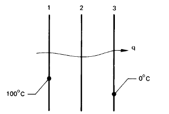

First i computed the rate of energy wrt time of the second plate:
$$dq_{2}/dt = A \sigma ((373)^4/2 + (273)^4/2 - T_{2}^4)$$
Equaliting it to zero we get the answer. But i am not sure why do we need to equality it to zero.
The q arrow on the figure suggest me that it is conservation of energy (radiation flux), but i don't get why.
The black body has transmission coefficient ##\tau = 0##, so i don't understand why the flux of radiation need to be equal. The body could pretty well absorb the energy coming from 1 and emite an energy to 3 totally different, couldn't?
For thermal equilibrium, outgoing =ingoing. If that were not true, the temperature ##T_2## would change
Yes i imagined it, but as the questions says nothing about equilibrium, i discarded the possibility. But since you pointed it too, i think that's enough to close this topic.
