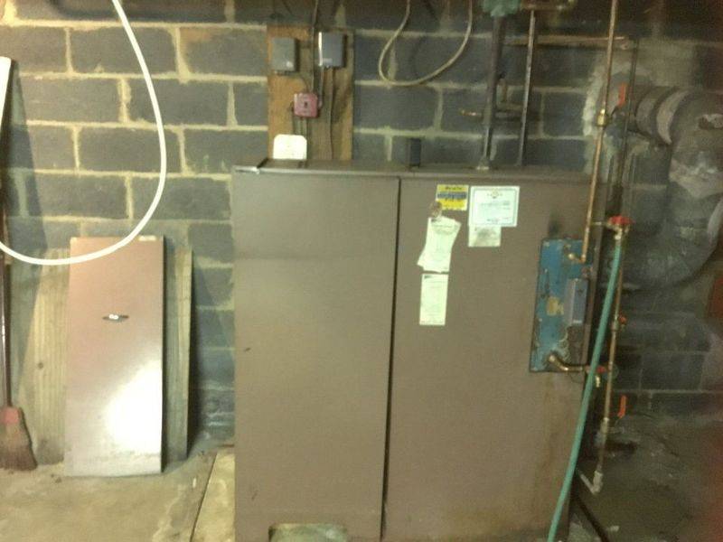

I begin to realize that I have electric hot water heater inside boiler. The heater with coils bring electricity to make water hot through the coils. Then why do I have oil tank that holds 200 gallons of heating oil? Do I have oil fired boiler?
Oil boilers have a flue/chimney for the combustion products. I don't see one I the photos.
There must be some model numbers on the boiler somewhere that you can Google.
Yes, on right of 0121.jpg shows 8 or 10 inch duct that goes into cement wall to chimney.
CWatters,
My basic question: why need water heaters if we use oil fired boilers? Boilers are to make water hot. I will check boiler again tmw for model and look up myself on web.
The manufacturer is Acroliner. The web says it's oil fired hot water boiler with a tankless coil. The description appears to tell me it both oil fired burner and an electric heater with coil.
I am not able to get model no and series. Too fine wears out over the years. The boiler has to be over 60 yrs old.
Boilers are closed-loop and are only there for heating. They can have an additional feature that runs a separate loop to heat potable water, but that is an optional extra.

I don't think I have - I don't think there is anything to be confused about anymore, except that the OP still thinks his water heater is electric, when clearly from the diagrams he posted it is just part of the boiler, running off the same oil he heats his house from. The downside there is that the boiler has to be on even in the summer, to get hot water!
