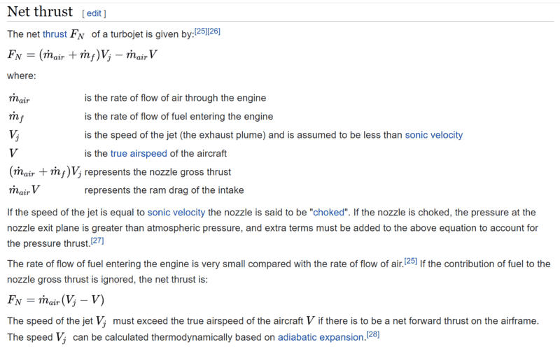

The factors mentioned above are not the whole story. Momentum is conserved. The momentum of exhaust gasses is calculated as mass times velocity. You have been focused only on velocity. What about the difference in mass flow with and without a compressor?
But word exchanges are not the best way to gain understanding. You need to look at the equations and the numbers. Below is a simplified thrust calculation from the Wikipedia article on turbojet engines.

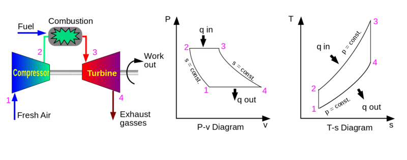

You really need to look at the thermodynamics to properly answer the question. While it is true that you must have a pressure increase to drive air through the engine and higher [compressed] volumes mean better thrust to weight ratio, that's not the main issue and doesn't explain why efficiency (for all thermodynamic engines) increases with pressure ratio. From wikipedia:
Pressurizing is what creates the difference between the two halves of the cycle. Without a compression step 1-2, there is no power extraction step 3-4, you just move back and forth on the heat input and rejection steps 2-3 and 4-1 without generating any power.
It's worth noting too that the energy of compression isn't lost, it stays in the working fluid, to be extracted back out later.
