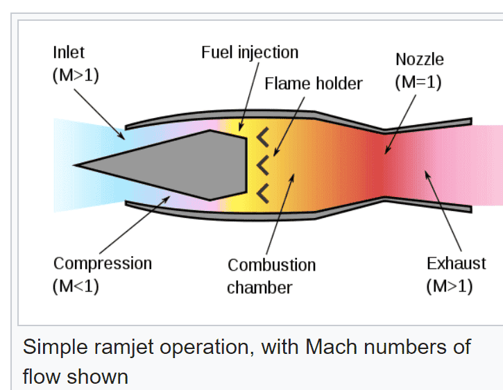

In fact, it may be simpler for you to first understand the ramjet engine that has no compressor, no turbine, yet still follows the same principles of physics.

Mass is conserved. Therefore the mass of air in plus the mass of fuel in must equal the mass of exhaust out.
The volume of the gases are greatly increased by burning and high temperatures. Therefore the volume flow of gasses out at the exhaust is much larger than the volume flow of air plus fuel coming in.
What does that tell you about the velocity of the exhaust gases compared to the velocity coming in? There is no need to even mention compressors, turbines, blades, or pressure to answer that question.

This is mind opening. Thank you. So the volume of air greatly increases due to heat gain in the combustor, and when this big volume of air pass through stator nozzles it exits at higher velocity than if it was not heated in the first place. It does make sense now.
