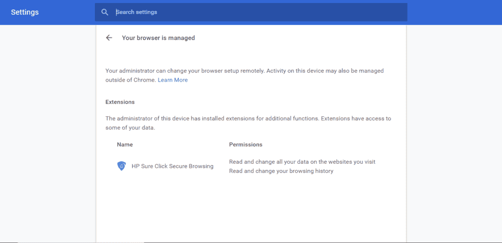

In my laptop, I have an extension installed by HP: HP Sure Click Secure Browsing. This application comes with HP systems, and the extension manages the browser (prevents harmful websites etc.) So in Chrome, I see this when I click on "Managed by your organization":
Chrome Settings page titled "Your browser is managed", listing the extension HP Sure Click Secure Browsing with permissions to read and change data on websites and browsing history.
Does your chrome show any such extension? If not, you can have a look at this answer:
