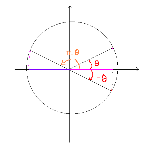

Here's an image I made (sorry for the bad quality) that will show you the intuition behind that formula:
$$\color{#50F}{\cos(\pi-\theta)}=-\color{fuchsia}{\cos(\theta)}.$$
