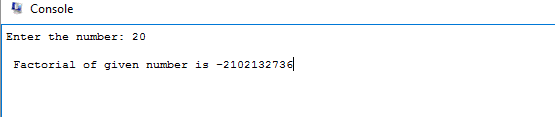

when I try to compile the MIPS instruction in order to compute the factorial of n number? i get the following error in the console as:
Enter the factorial number: 20
factorial of given number: -2102132736
The output which I am getting as negative integer of a given factorial instead of positive integer.

Looks like a size or a formatting problem:
2102132736 is 31 bits and -2102132736 is 32 bits interpreted as a 4 byte integer (first bit a sign bit)
For 20! you need more than 62 bits
20! truncated to 32 bits is -2102132736. It looks like you are calculating to 64 bits then displaying 32 bits.
