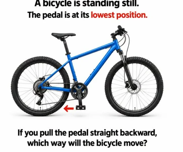

Simple puzzle: bicycle motion
  • Thread starter Thread starter DaveC426913
54 replies · 6K views
DaveC426913
2025 Award
24,711
9,135
TL;DR
Most "puzzles on SocMed are dumb. This one was a least a tiny bit challenging.
Clarification: Assume the bicycle is supported from falling over, but not prevented from moving forward or backward.

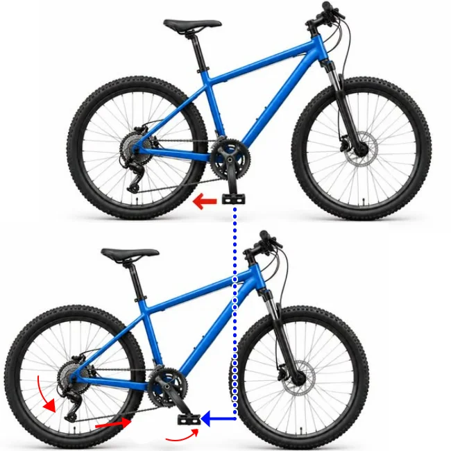

At first, I thought it was simple, but one commenter pointed out a very non-intuitive effect.
I had to go do the experiment myself with my bike to be sure.
Yes, the bike moves backward.
Its weirder than that though. The bike moving backward engages the gears and chain, causing the pedal to rotate counterclockwise, even as it is moving backward (leftward).
I had to make a little diagram to explain it to commenters:
The pedal moves backward with the bike (blue line and arrow) even as it rotates CCW (red arrows).
Pretty cool.

No, it has nothing to do with chain slack. It moves backwards without slipping even after the chain is tensioned.
It's the same principle as with the spool pulled by the string from underneath.
Interestingly it moves in the same direction as the string pulling it but faster than the string. So it's also the same principle that allows you to move directly downwind faster than the wind that is propelling you.

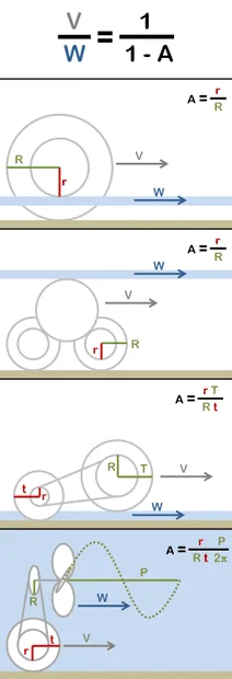

Let us write down the equations. Assume that there is no slipping between the bicycle wheels and the floor. Then this is a system with ideal constraints and a single degree of freedom.
Let us fix a point ##A## on the bicycle frame and let ##x## be the coordinate of this point on the horizontal axis. This is the generalized coordinate of our system. We consider the axis to be directed from left to right. Let ##\boldsymbol F## denote the force acting on the pedal. This force is directed left horizontally. The corresponding generalized force is
$$Q=\left(\frac{\partial \boldsymbol {r}_{pedal }}{\partial x},\boldsymbol F\right).$$
And this is where the most interesting part lies. The answer to the problem depends on the sign of the function ##Q## and is determined solely by the kinematics of the system. Indeed, let us write Lagrange's equation:
$$\frac{d}{dt}\frac{\partial T}{\partial \dot x}-\frac{\partial T}{\partial x}=Q,\quad\dot x(0)=0.$$
Here, the kinetic energy of the system has the form
$$T=\frac{1}{2}a(x)\dot x^2,\quad a>0.$$
Lagrange's equation takes the form
$$\ddot x=\frac{1}{a}\left(Q-\frac{1}{2}a'\dot x^2\right).$$
Thus, the direction of motion of the bicycle at the initial moment of time is entirely determined by the sign of the bracketed term on the right-hand side of the equation, and this sign is determined by the sign of ##Q##.
To summarize the analysis, the solution to this problem can be stated as follows:
If rolling the bicycle slightly to the right causes the pedal to displace rightward from its initial position, applying a leftward pull via the string (as shown in the video) will move the bicycle to the left.
Conversely, if rolling the bicycle to the right causes the pedal to shift to the left relative to its starting point, pulling the pedal leftward will result in rightward motion of the the bicycle.
wrobel said:
The answer to the problem depends on the sign of the function Q and is determined solely by the kinematics of the system.
Yes, without slipping it becomes a purely kinematic/geometric problem. It can be generalized with the formula in the figure below which depends only on the gear ratio A. If 0<A<1 then V/W > 1, so the vehicle moves in the same direction as the propelling object (blue) but faster.
A regular bicycle is like the 3rd variant shown below, if you make t (back wheel radius) > T (pedal lever arm).

Except: no.
Pulling the pedal to the left causes the bicycle to move left, even as the pedal rotates CCW.
So ... pedal goes left, bike goes left?
DaveC426913 said:
Except: no.
You should read the statement by @wrobel that you quoted more carefully, in particular the if-part, which doesn't apply to regular bikes.
And you should watch the video in post #3 where both cases described by @wrobel are demonstrated.
Case 1: Regular bike (A < 1)
Case 2: Custom bike with an ultra low gear (A > 1)
If A<1 then pulling the string to the left will move the bike to the left. The pedal then also moves to the left, relative to the ground.
Additionally, if 0<A<1 the bike will move faster than the string is moving.
