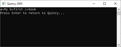

C:
#include<stdio.h>
int main(){
    char str[]="My first book";
    char *a,*b,*c;
    sscanf("%s %s %s",a,b,c);
    printf("a=%s b=%s c=%s",a,b,c);
I want the output: a= My b=first and c=book. But it does not work, why?

When you say "it does not work," what do you mean by that?
Are you getting a compiler error? Run-time error?
Is there any output?
One problem that I see immediately is that your a, b, and c pointer variables are uninitialized -- whatever memory they point to isn't something that you have set up. You should never use a pointer that hasn't been initialized to a valid memory buffer.
When did you use str besides its declaration? I would take another look at your sscanf.

C:
#include<stdio.h>
int main(){
    char *a,*b,*c;
    sscanf(str,"%s %s %s",a,b,c);
If I write like this, I am getting seg fault
So, what about your pointers? What's going on with those?

The reason you're getting a seg fault is that sscanf() is attempting to store parts of the character string into memory that doesn't belong to the program.
Instead of declaring a, b, and c as you have done (as uninitialized pointers), try declaring them as arrays of some fixed size, with each one declared to be large enough to hold a substring of the original string.
C:
char a[20], b[20], c[20];
