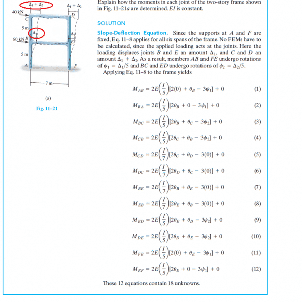

Why does the author use Δ1 + Δ2 for C instead of just Δ2?
3 replies · 1K views · last reply
fonseh
521
I know that when the 80kN act on B , the frame will be dispalced by Δ1 to the right .. When the 40kN act on C , the frame will be displaced Δ2 to the right ... Why the author use Δ1 + Δ2 for C ?
Is the author wrong ? I think the author should use Δ2 at C instead of Δ1 + Δ2 for C , am i right ? Δ1 can / cannot be the same as Δ2 [/B]

The two horizontal loads are applied together. The author chooses to define Δ2 as C's additional displacement beyond that of B.
Do you have an issue with an equation based on that?
why The author chooses to define Δ2 as C's additional displacement beyond that of B ? why can't the author define the displacement at C = Δ2 only ??
If you follow through the equations, some of them turn out simpler with the author's choice. Whether it is simpler overall I have not tried to determine.
