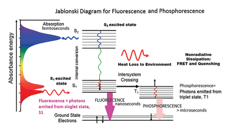

The part I was not sure about, “intersystem crossing.”
This is the link, with that diagram below.
https://www.horiba.com/int/scientif...e-spectroscopy/what-is-the-jablonski-diagram/
“As shown in the figure, the final photo-emission transition can either occur through a fast singlet state (fluorescence) or through a slower triplet state (phosphorescence).
In conventional photoluminescence, photons are emitted at higher wavelengths (lower energy) than the wavelength of the absorbed photons.”
That's the key. The energy has to go into a mode that is metastable, where decay by emission of photons has a low probability, meaning a long lifetime.
Absorption and emission are symmetric processes. If it is easy for a molecule to absorb light at a given frequency, it will be easy for it to emit the light back. To get fluorescence at another wavelength or phosphorescence, there needs to be faster decay mechanisms that will change the state of the molecule before simple reemission takes place.

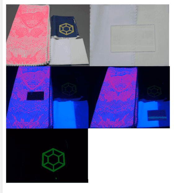

Reason I asked to see if there was any fundamental difference between the phenomena.
I took a few images to illustrate:
1/Top row D65. Coloured materials left. Cotton fabrics (white and cream) have been through the same bleach except RHS has optic.
2/Middle row UV. Fluorescent pigment and optic glow, the filter stops the effect
3/Bottom row No light. The GID application continues after stimulation.
This thread is kind of a random walk through all things fluorescent.
The original question is answered: this occurs on all sorts of timescales, including the very short and the very long.
The thread also discusses how practical long-lasting fluorescence can be achieved: you need three energy levels: low to high is fast, high to mid can be comparably fast, and mid to low is slow.
If there are more questions, it's best to be explicit about what you don't understand.
