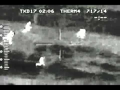

The EM radiation emitted by humans is almost entirely in the far IR range. Hence we can't see it except on special IR cameras.

They do! Your eye is a poor detector that cannot detect this "glow".
And oh, wait till you find out that the human body, on average, also emits about 0.3 mSv per year from the radionuclides in our bodies. We definitely "glow in the dark"!
Zz.
+1
And a number of nocturnal animals can 'see' the bodies of mammals under conditions that humans would describe as darkness. See this link about various snakes that hunt at night. As far as these snakes re concerned, we "glow".
