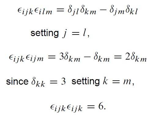

quietrain
648
does anyone know why
djmdkl = dkm
when j = l
thanks!
can i interchange it to djmdkl = dkldjm ?
since l = j
do the "j" in dkjdjm signify summation?
so i get dk1d1m + dk2d2m + dk3d3m ?

It's not. For example, [itex]\delta_{3m}\delta_{k3}[/itex] is not equal to [itex]\delta_{km}[/itex] in general. It is when m=k=3, but not when m=k=2.
On the other hand [itex]\delta_{jm}\delta_{kj}=\delta_{km}[/itex], because this is a sum with three terms, and in every term, the first factor is 0 if j≠m and the second factor is 0 if j≠k. So if k≠m, all the terms are =0 because they all contain at least one factor that's zero, but if k=m, the term with j=m=k is =1 and the others =0.

quietrain said:
but if i let j=l , issn't djmdkl = djmdkj ??
No. There's only one term on the left and three terms on the right. (Before we have actually checked, it's conceivable that the value of the expression on the left is the same as the value of the expression on the right for all values of the indices. But if you understand the notation at all, it's immediately obvious that the two expressions represent different calculations).

QUESTION 1)
oh.. so ,d11+d22+d33 is not the same as dk1d1m + dk2d2m + dk3d3m
because k or m cannot be 1,2,3 in the same expression?
Q 2)
for dkm = dk1d1m + dk2d2m + dk3d3m
so i only get d11 = d11d11 +0 + 0 = 1
so its kind of redundant to write the other two terms? unless i specify that k and m goes from 1 to 3 in dkm?
or does writing dkm already implies that k and m must go from 1 to 3?
Q 3)
with regards to the l=j part,
i was actually looking at this,
(weird the image code is not working?)
so after j=l, how did it become 3 dkm - dkm ?
3 dkm came from this part : djldkm right? while
- dkm came from the contraction of djmdkl ? but you said this contraction is wrong in your first post?
also, how did the 3 dkm part have a 3 popping out? shouldn't djldkm = 1dkm where l=j ?
or is the crux of this problem lying with the levi -civita symbol on the left? where there is actually a summation symbol for repeated indices going from 1to 3?
so that i get { d11+ d22 +d33 }dkm which is 3dkm ?

Q 3)
I don't like how the author uses the phrase "setting [itex]j=l[/itex]". I would interpret that as "when j and l represent the same number, we get..." That's not at all what he's trying to say. What he meant to say is that the statement
[tex]\text{For all $j,k,l,m\in\{1,2,3\}$, we have } \epsilon_{ijk}\epsilon_{ilm}=\delta_{jl}\delta_{km}-\delta_{jm}\delta_{kl}.[/tex] implies the statement [tex]\text{For all $k,m\in\{1,2,3\}$, we have }\epsilon_{ijk}\epsilon_{ijm}=\delta_{jj}\delta_{km}-\delta_{jm}\delta_{kj}=3\delta_{km}-\delta_{km}=2\delta_{km}.[/tex] You might want to read my first post again to see what I'm actually saying.

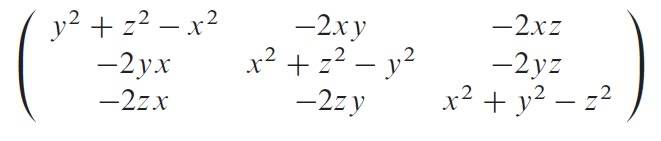

also with regards to the quotient law of tensors that says
(A)(B) = C , if B,C are tensors, A is also a tensor ,if order of C = order of A + order of B - 2
so if i want to show that A is a 2nd order tensor, the idea to solving is just to mulitply it by a order 0 (scalar) so that i get order 0 (scalar)
so its something like this right
(A) (scalar) = (scalar , e.g 0 to make life easier)
so what is the idea to figuring out what (scalar) to mulitply A by?
because my prof gave me a 2nd order tensor (3x3 matrix) with crazy sin and cos terms everywhere
I'm actually not familiar with this rule. Can you state it exactly as it appears in your book or your lecture notes? (I assume that there are indices that you haven't included here).
if i have matrix A (3by3)
so if i mulitply it with a scalar B ( say 0) , then i get C = 0
then wouldn't it fulfill the quotient law?
since the orders of tensors are for A = 2 (M), B = 0 (N) , C = 0 (M+N-2)
What you're describing now has nothing to do with the quotient law, and it's not because of the orders of the tensors. Look at page 41 again. What the quotient law says about your components [itex]A_{ij}[/itex] and their relationship with a scalar B is this:
Suppose that for all real numbers B, [itex]A_{ij}B[/itex] are the components of a tensor. Then [itex]A_{ij}[/itex] are the components of a tensor.​
This is of course an entirely trivial statement.
What are you trying to do exactly? Are you trying to figure out if the numbers [itex]A_{ij}[/itex] are the components of a tensor? That wouldn't really make sense. You can always pick a coordinate system, and define A to be the tensor that has components [itex]A_{ij}[/itex] in that coordinate system. So no matter what numbers the [itex]A_{ij}[/itex] are, they are the components of infinitely many tensors. The question "Are these the components of a tensor?" only makes sense when what you've been given associates an indexed set of numbers with each coordinate system. Is there something about your matrix that gives you a reason to interpret it as an association of nine numbers with each coordinate system?

er i don't really understand what you mean by
but the question is something like this ,
show that the following is a 2nd order tensor
so am i suppose to find a scalar to multiply it with, so that it gives me back a scalar so that i satisfy the quotient law? issn't this what the law says?
I mean that a 3x3 matrix is just a set of nine numbers, but a tensor with two indices is something that associates nine numbers with each coordinate system (in a way that's consistent with the tensor transformation law).
To make sense of this, we have to figure out a way that this associates nine numbers with each coordinate system. Can you do that? The only clue we have is the notation. (x,y,z) is a standard notation for the components of a vector in a coordinate system. (Hm, this actually looks pretty complicated).
I told you what the quotient law says about this matrix and its relationship to a scalar B. It says something completely useless (that if A times a number is a tensor, then A is a tensor...this is useless because it's not easier to show that A times a number is a tensor, than to show that A is a tensor). What makes you think this problem has anything to do with the quotient law?

with regards to the quotient law,
the question asks me to use the quotient law to show that that matrix is a 2nd order tensor. but anyway, from what i see, the matrix is symmetric. so if i diagonalize the matrix
P-1AP = D
is this a form of the quotient law?
Have you really told me everything that this problem says?
P-1AP = D
What makes you think that it might be?
The fact that the matrix is symmetric is a good observation. Since symmetric matrices can be diagonalized by orthogonal matrices, we know that if the components of the matrix are the components of a tensor, there's a coordinate system in which it's diagonal.

Fredrik said:
Have you really told me everything that this problem says? What makes you think that it might be?
yes that's all the question wants. use quotient law to show that matrix is a 2nd order tensor.
so how do i proceed? is diagonalizing it the right way?
i think my prof also said that by the quotient law, if the matrix
(A) (scalar) = invariant, it shows that A is tensor. or something along the lines of these.
anyway, i still don't really have any idea how to solve this quesiton
i don't seem to be able to draw the link between diagonal matrix and quotient law
