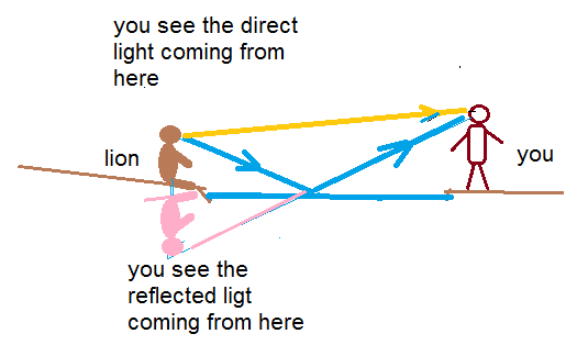

See the picture. It shows light rays starting from the head of the lion. The orange ray directly goes to your eyes; the blue one reflects from the water, and then reaches your eyes. Your brain knows that the light travels along straight lines, so you see the head of lion in the direction from where the ray came. You see one lion head where it really is; and an other one deep inside the water: the mirror image .
(Sorry, I could not draw a better lion.)
