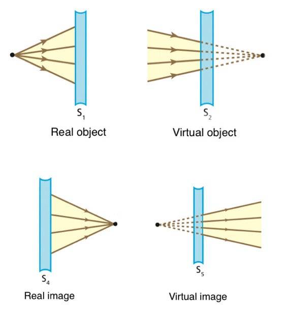

Can I chip in? The terminology 'virtual object' may be the source of confusion.
(From https://physics.stackexchange.com/q...rence-between-real-and-virtual-objects-optics)
Real objects are points from which light rays diverge.
Virtual objects are points towards which light rays converge.
(You might find that counter-intuitive, but that's the accepted terminology.)
(Real images are points towards which light rays converge.
Virtual images are points from which light rays diverge.)
There's even a Khan Academy video exaplaining virtual objects:

With reference to the Post #11 video:
Null_Void said:
In the end we have a double lens system and we are to find where the final image will be formed and naturally we use the concept of a virtual object to do so.
My question is, does a virtual object carry the same properties as a real object?
It depends what you mean by 'properties'. The simple answer is 'no' - or they would be the same!
Light rays emerge (diverging) from a real object. This is not true of virtual objects.
A virtual object is just a convenient concept when analysing multi-element systems. It corresponds to the position where element number N would have formed an image if element number N+1 hadn't prevented it. This is then the position of the object of element N+1.

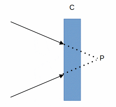

Try this.
You have an optical component, C, with incident rays travelling left to right. Suppose C's incident rays converge at point P situated on the right of C.
We say P is the virtual object for C . Think of P as attracting the incident rays.
A virtual object acts as if it is ‘pulling in’ C’s incident rays. (Compare that to a real object.)

I think I get it now. I believe my confusion was due to the assumption that virtual objects act like real objects. Nevertheless, your posts cleared it up.
Thank you @haruspex and @Steve4Physics for your time and patience!
