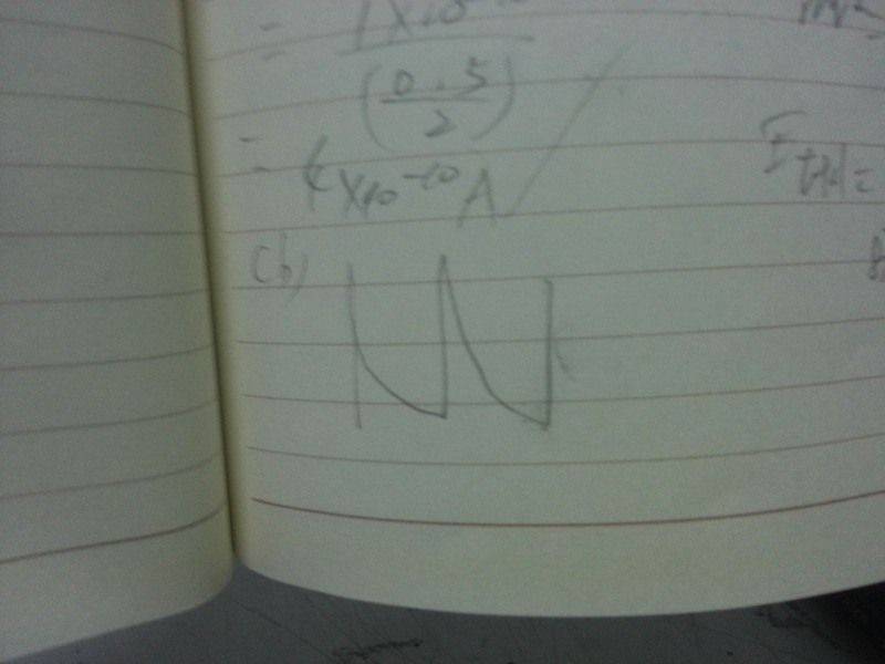

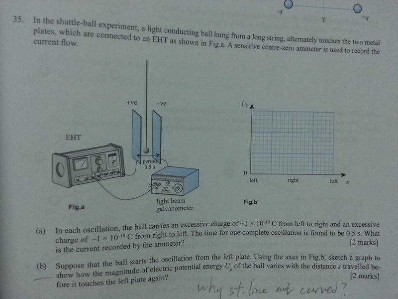

By the inverse proportionality relation between electric potential energy and distance, why is the graph composed of straight lines only but not concave upwards slopes? My sketch and the solution are attached below.
  • Printed exam figure of a shuttle-ball apparatus with two metal plates marked +ve and -ve, and a blank graph beside it of Up against s, labelled left, right, left.

  • Handwritten sketch labelled (b) of a sawtooth-like graph in a notebook, with a series of decaying curved segments that rise sharply and then fall back, above partial working with fractions and units.
When you say "inverse proportionality" between U and distance, are you thinking of U = kq1q2/r? That formula is for the potential energy of two point charges. But the problem deals with a point charge between parallel plates.
yeah I was thinking of that.
So the relation when in parallel plates is linear? Why??
Can you describe the properties of the electric field between the plates?
the electric field is nearly uniform and varies linearly across the plates?
E is (nearly) uniform, which means that it essentially doesn't vary at all as you move from one plate to the other. So, what can you conclude about the force acting on the ball as it moves between the plates?
The force is constant and work done varies linearly with distance?
Yes, that's right.
