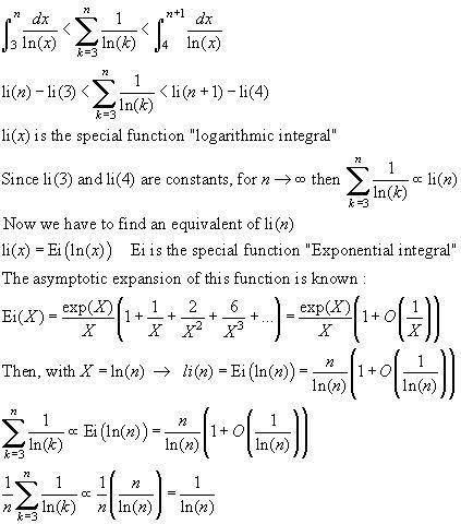

Hello,
In my probability course it is used that [itex]\frac{1}{n} \sum_{k=3}^n \frac{1}{\log k} \propto \frac{1}{\log n}[/itex].
I hope I'm not being daft: can somebody enlighten me on why this is so?
Hello,
a method to find a equivalent is to border the sum by integrals (in attachment)
  • Handwritten-style typeset derivation: integral bounds of 1/ln(x) around the sum of 1/ln(k) from k=3 to n, then li(n) asymptotics using Ei(ln n) expansion, concluding the sum over n of 1/ln(k) is equivalent to n/ln(n).
Are you sure jjacquelin that this series 1+1/x+2/x^2+6/x^3 converges? I take it to be sum_k k!/x^k.
I took a similar approach by integrating by parts, but sadly also ended up with a divergent series. I think this is a non-trivial question to prove from scratch.

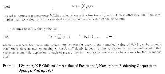

We don't consider the infinite series which doesn't converge. We consider a limited number of the first terms in order to derive an equivalent. This is the usal way for asymptotic series.
In fact, in my previous attachment, where a typographic character which is not exactly the good one. In the asymptotic formula the "equal" should be the "tilde". (see attachment)
  • Page from the Atlas of Functions showing two equations: a convergent infinite series sum of g(j,x) for j from 0 to infinity, and an asymptotic series sum of g(j,x) for j from 0 to infinity with x tending to infinity, with explanatory text about convergent and asymptotic series.
