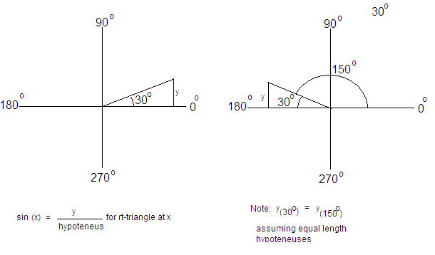

It is a practical way to simplify calculations taking advantage of the symmetry nature of the quadrants.
Would this help?:
https://courses.lumenlearning.com/csn-precalculus/chapter/reference-angles/

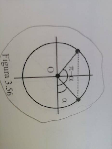

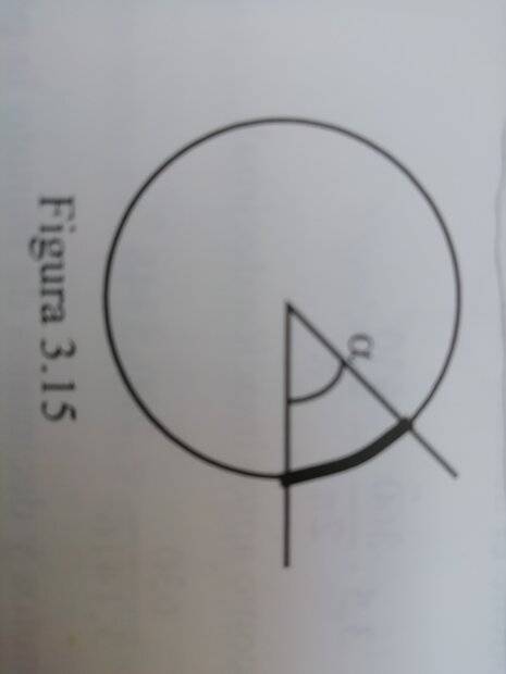

Hi, @shirozack
A circumference is the set of points of the plane that are distant to another point ##O##, called center of the circumference, a constant amount ##r## called radius of the circumference
Provided any angle ##\alpha##, we consider a circumference of radius 1 and with center the vertex of the angle; then, we will measure the angle as the length of the arc of circumference equal to the radius:
The aim is now in measure the length of the arc of a circumference. The expression that allows us to compute the length of a circumference of radius ##r## is ##2\pi\,r##, and, as we have taken ##r=1##, then the measure of the whole radius is ##2\pi##. This unit of measure is a radian, i.e, the whole angle sizes ##2\pi## radians.
So an angle of ##g## degrees sizes ##\frac{g}{360}\cdot{2\pi}=g\cdot{\frac{\pi}{180}}## radians.
Then one radian is ##\frac{180}{\pi}## degrees
An important theorem of plane geometry that for sure the reader will know, asserts that the sum of the sizes of any triangle is ##\pi##
@shirozack, I will show you a reasoning for this very simple, if you want. Now I leave this in your hands, and go straight to the question:
Two angles are complementary if their sum is ##\frac{\pi}{2}##
So ##\sin{(\pi-\alpha)}= \sin\alpha##
Best wishes!

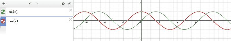

Simply, the answer to the "why" is that the sine function is defined that way. If you calculate it based on the y-axis, it would be a different function.
Here is ##\sin(x)## graphed together with ##\cos(x)##.
##\sin(x)##, with the current definition, has very useful applications in physics and applied mathematics.

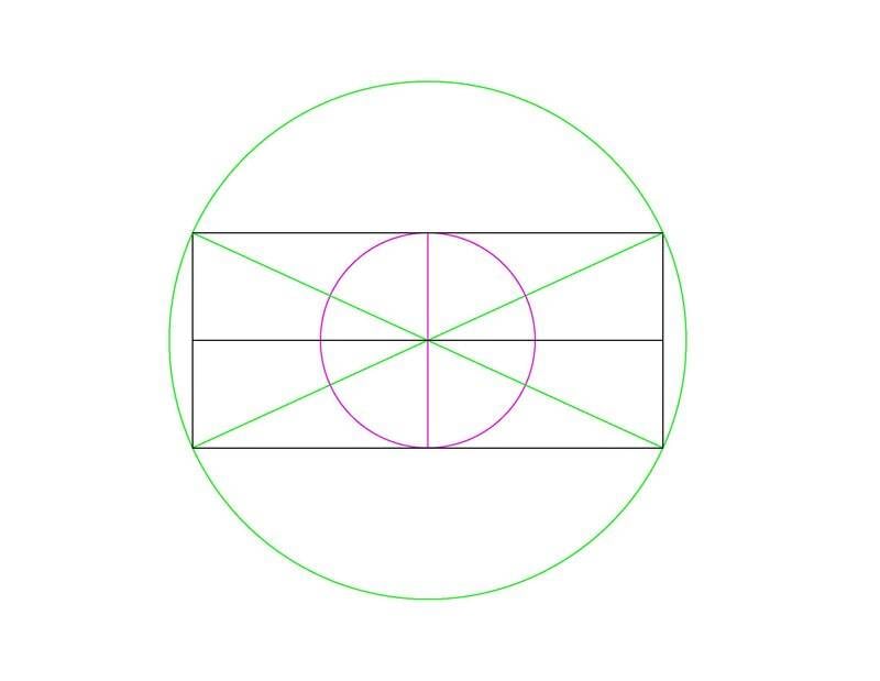

You can derive it analytically too. Expand ##sin(2\pi -\alpha)## using ##sin## of the sum of angles.
Note how the magenta/green proportion is maintained for lines and radii of circles alike.
