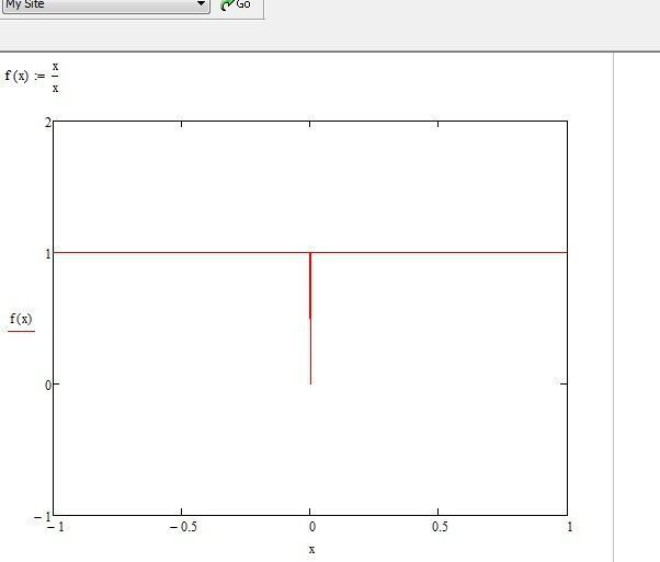

I was doing some homework, trying to solve an equation by using algebra instead of reading from a graph (like I was supposed to), and I stumbled upon something:
Check out the attachment.
Why does the graph of f(x)=x/x have a T shape, with the vertical line starting at x=0 ? I know the graph isn't kind-of supposed to be defined for x=0, but I can't explain this anyway.
  • Mathcad plot of f(x) := x/x over x from -1 to 1: a red horizontal line at f(x) = 1 with a short vertical red segment at x = 0 spanning from 0 to 1.

Hi Nikitin! :smile:
Nikitin said:
… I know the graph isn't kind-of supposed to be defined for x=0, but I can't explain this anyway.
It should just have a tiny hole at x = 0,
since, as you say, it isn't defined there.​
I expect that particular graphing site (which one is it?) has a special way of dealing with 0/0 …
it looks like it's putting it equal to 0 …
so it joins that point, (0,0), to the rest of the graph by a line. :smile:​
I'm using mathcad. great program.
anyway, I think it's supposed to be like this.. I used this function A=[(x-1)(x-2)^2 +4]/x which had a similar line going vertically from y=0 to y=8.
The line actually represented that for x=0 A could be whatever from 0 to 8, and that actually made sense and was correct. I know my situation is terribly explained, but point is I think the line is supposed to be there.

By default, Mathcad defines 0/0 as 0. There is an option to turn it off, thus allowing the user to catch the error and deal with it according to the nature of the problem.
NR
from the main menu:
Tools \ Worksheet Options ...​
This brings a dialog box with several tabs, choose the 'Calculation' tab and clear the '0/0=0' checkbox.
