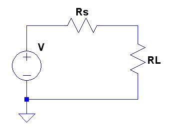

When the load impedance is lower than the source impedance of a Voltage source, why does the voltage drop?
What exactly happens when you draw more current.

What's the voltage over the RL?
Circuit schematic of a voltage source V in series with source resistance Rs, feeding load resistor RL, with the bottom of the loop grounded.
Its RL/(RL+Rs).
I get it now. More voltage is dropped across the internal resistance Rs than the load resistance. I was thinking in terms of internal resistance/load resistance. But never arrived at the answer.
