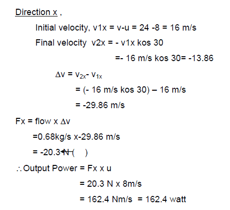

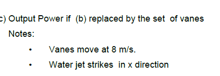

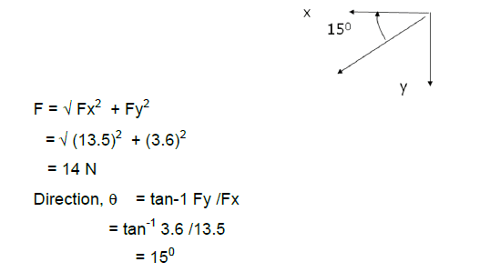

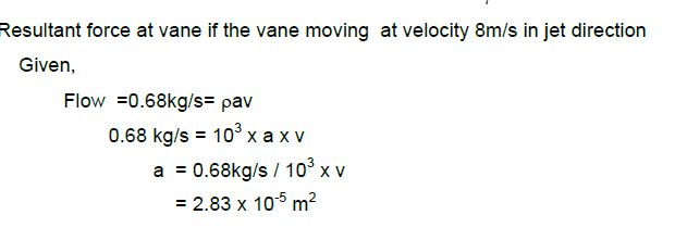

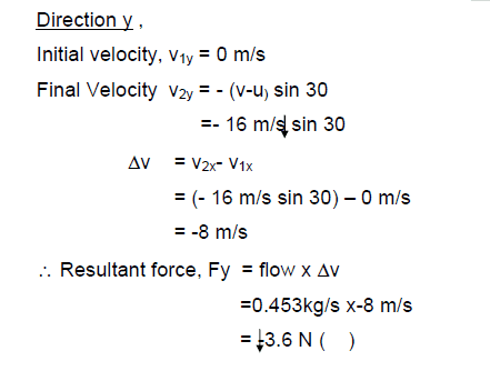

for part c , why when the vane is moving , the flow rate doesn't change ? ?
The flow rate is given by the formula Q=Av , where A = area , v = velocity . IMO , when the velocity of vane change , the flow rate is no longer 0.687kg/s , it should be 0.68kg/s = (10^3)(A)(24) , A= 2.83x10^-5 (m^2) , so the new Q should be pa(v-u) = (10^3)(2.83x10^-5)(24-8) = 0.453kg/s , am i right

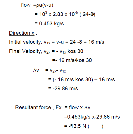

in part b , the author changed the flow rate because of the vane is moving at 8m/s , why wouldn't the flow rate in part c also change ?

Excuse me, I misread: in part (b) the flow rate is unchanged - the water still leaves the pipe at the same mass rate.
However, the rate that the water hits the single vane is lower because the relative velocity is lower because the vane is moving away.
In part (c) the single vane is replaced by "the set of vanes". What is special about the set of vanes?

why not the situation in b same as the situation in c ? in situation c , the author means replacing the vane with the new vane moving with 8ms^-1 . ( the original moving vane is not moving , correct me if i am wrong)

(c) power output if (b) is replaced by the set of vanes
So, initially the vane is not moving - that is part (a). That vane is replaced by one that is moving - that is part (b). In part (c) the single moving vane is replaced by "the set of vanes", and changes the calculation required from force to power ... so what is special about the set of vanes that it will produce a power output?
I agree, and if I'm reading post #4 correctly, so does Simon.
I cannot make sense of the question in part c. The reference to 'the' set of vanes implies there is further information that you have not quoted, probably the number of vanes. However, the calculation of power you posted still only considers one vane, and appears to be appropriate for the circumstances in b, no replacement necessary (except, as noted, the answer should be 2/3 that given).

do u agree that the flow rate should be 0.453kg/s as in b ? sorry , that's all the info i have . The author only gave that ,
Yes, 0.68 x 2/3 = 0.453...
