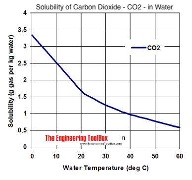

Ethanol is fully soluble in water, wheras CO2 has a solubility very low.
Most of the bubbles produced at room temperature would be comprised of mainly CO2, and some ethanol due to its vapourization pressure at that temp, as well as some water vapour.
Note that the yeast at the beginning will convert the sugars by both processes of aerobic respiration, with production of water and CO2, as well as anaerobic fermentation, with production of ethanol and CO2. The ratio of these chemical procedures progresses from aerobic to anaerobic as the oxygen supply within the bread diminishes.
https://www.engineeringtoolbox.com/gases-solubility-water-d_1148.html
The bubbles formed at room temperature are mainly of CO2 composition.
In the oven as the temperature rises, the bubbles increase in size. A bit more ethanol vapourises contributing to some increase in size. Until the yeast is completely dead due to the heat, more CO2 is being produced. Most of ethanol is still being absorbed by the water in the bread.
The final result is that the bubbles form from CO2 gas being given off from the yeast, the ethanol remains as a soluable mixture with the water in the bread.
