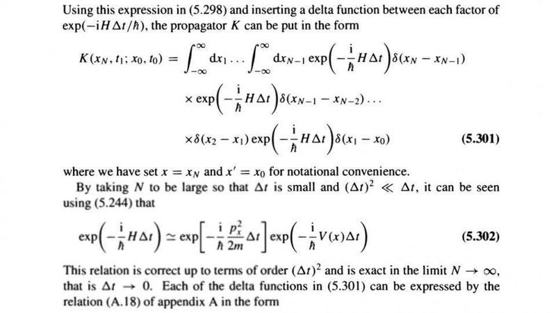

Why is (5.302) an approximation instead of an equality?
Let ##T## be the operator ##\frac{p_x^2}{2m}##.
By the law of indices, we should have ##e^{-\frac{i}{\hbar}(T+V)\Delta t}=e^{-\frac{i}{\hbar}T\Delta t} e^{-\frac{i}{\hbar}V\Delta t}## exactly. Is it because ##T## and ##V## do not commute? So the correct equation should be ##e^{-\frac{i}{\hbar}(T+V)\Delta t}=\frac{1}{2}[e^{-\frac{i}{\hbar}T\Delta t} e^{-\frac{i}{\hbar}V\Delta t}+e^{-\frac{i}{\hbar}V\Delta t} e^{-\frac{i}{\hbar}T\Delta t}]##?
But if this is so, shouldn't (5.302) be correct up to terms of order ##\Delta t## instead of order ##(\Delta t)^2## as claimed by the book?
Happiness said:
[...] Is it because ##T## and ##V## do not commute?
Yes.
Not in general. Check out the Baker-Campbell-Hausdorff formula(s).
Likes vanhees71, Happiness and bhobba
When I work out the term of order ##(\Delta t)^2##, the left hand side gives ##\frac{1}{2}(-\frac{i}{\hbar})^2(T^2+TV+VT+V^2)(\Delta t)^2## but the right hand side gives ##\frac{1}{2}(-\frac{i}{\hbar})^2(T^2+2TV+V^2)(\Delta t)^2##. They are not equal. So is the book wrong?
Which book is it?
strangerep said:
Which book is it?
It's Quantum Mechanics 2nd ed. by Bransden & Joachain, page 243.

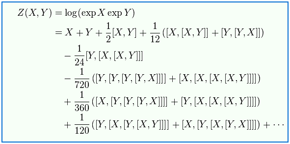

Since (https://en.wikipedia.org/wiki/Baker–Campbell–Hausdorff_formula)
then to the second order, ##\ e^Xe^Y=e^{X+Y+\frac{1}{2}[ X , Y ]}##.
So shouldn't it be
e^{\lambda (T+V)/N} = e^{\lambda T/N}\ e^{\lambda V/N}\ e^{\frac{1}{2}(\frac{\lambda}{N})^{2} [ T , V ]}?
This equation is correct to all orders provided that
[ X , [ X , Y ] ] = [ Y , [ X , Y ] ] = 0 .
We speak of “orders” when we expand the exponentials.
So shouldn't it be
No. Again, if [ T , V ] commutes with both T and V, you can write
e^{\lambda (T + V)/N } = e^{\lambda T/N} e^{\lambda V/N} e^{- \frac{1}{2}(\frac{\lambda}{N})^{2} [ T , V ] } .
Notice the minus sign on the right hand side.
