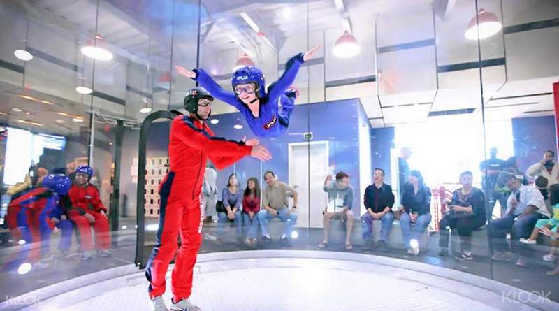

It depends on the size of the wing... :smile:
Or do you mean like indoor skydiving?
https://www.iflyworld.com/
https://www.tmtmtour.com/wp-content/uploads/2018/01/ifly2.jpg

i was talking about thunderstorm
there is a storm coming to Delhi with speed 60 kmph.
I was thinking if people would start flying. Or maybe the small dogs on street.

Looks like 60-80mph is pretty close to the limit...

My grandson "flew" in one of those iFLY vertical wind tunnels and he and his adult "instructor" where suspended with a air velocity of about 100 mph. The force of wind applied perpendicularly on a one sq foot surface is about 49 lbs.
