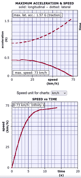

Finally, this acceleration simulator does all these calculations and gives something like this for your vehicle:

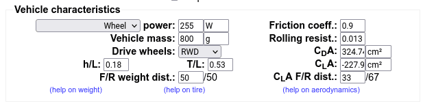

Vehicle characteristics input form from an acceleration simulator: Wheel dropdown, power 255 W, vehicle mass 800 g, RWD drive wheels, h/L 0.18, T/L 0.53, F/R weight distribution 50/50, friction coefficient 0.9, rolling resistance 0.013, CdA 324.7 cm², ClA -227.9 cm², ClA F/R distribution 33/67.

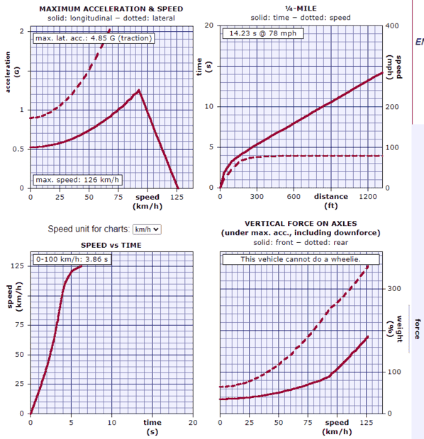

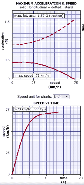

Two plots from a vehicle acceleration simulator: top, maximum acceleration and speed, with lateral and longitudinal curves against speed in km/h; bottom, speed versus time from 0 to 73 km/h.
giulioooooh said:
which should tell me the acceleration in relation to time up until the point in time when max acceleration (limited by the motors) is achieved?
So you would reach a maximum acceleration of 0.45 g at around 14 km/h, which should happen after about 0.9 s.
The maximum speed would be 73 km/h reached after 13.64 s.

Hey Jack, I'm back again. That Calculator you linked and that website in general is very useful, thanks so much for linking it. I still got a bunch of questions though:
1. You set power to 255W although I have two motors with 255W each, so I think that I didn't explain myself completely, right? Or am I overlooking something?
2. I don't really understand how you came up with ##F_{lift} = 0.5C_L Av^2##. When looking at http://hpwizard.com/aerodynamics.html, CL,D*A=CL,DA, so I don't quite understand why you have that 0.5 in your lift equation. Is that just to cancel out the 0.5 in the Drag equation? Do you even need those "0.5"s in the first place or can you just leave those out if you do it for both?
3. (Still kind of part of question 2 and not really a question:) Regarding the settings you put into the acceleration sim, it doesn't really make sense to me why the drag factor should be bigger than the absolute value of the lift factor if (at least in CFD) downforce is bigger than drag. Assuming that I leave out that 0.5 factor I just talked about on both, I get a CLA=457.14cm² and CDA=161.45cm².

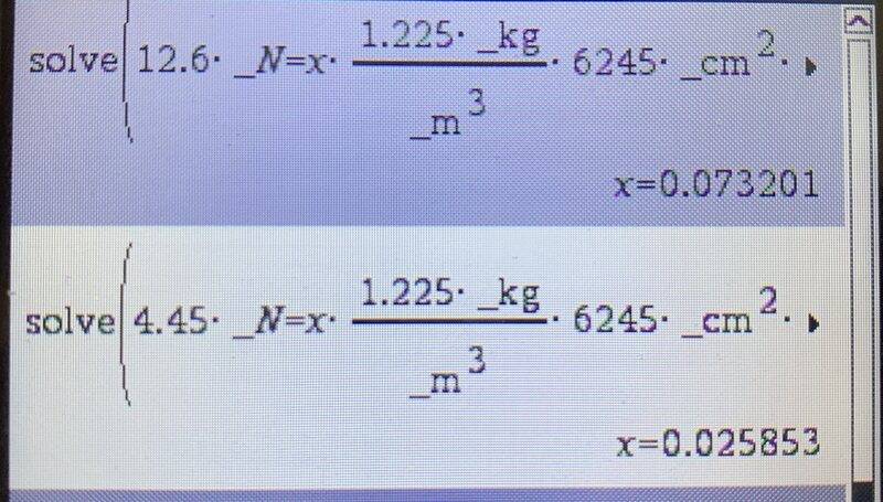

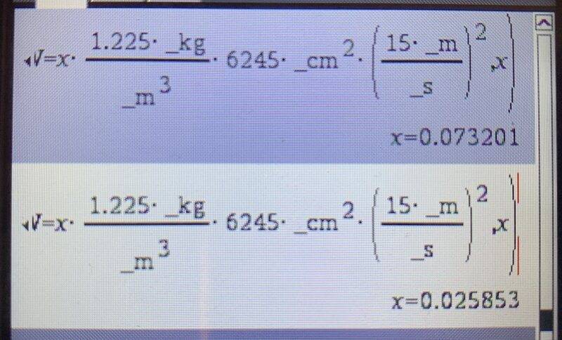

Two solve expressions in a math software window: 12.6 N = x * 1.225 kg/m^3 * 6245 cm^2, giving x = 0.073201; and 4.45 N = x * 1.225 kg/m^3 * 6245 cm^2, giving x = 0.025853.

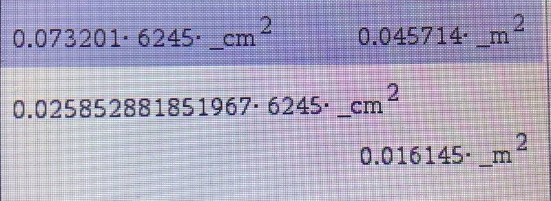

Screenshot of a calculator showing products of two values: 0.073201 times 6245 cm squared, 0.045714 m squared, 0.025852881851967 times 6245 cm squared, and 0.016145 m squared.

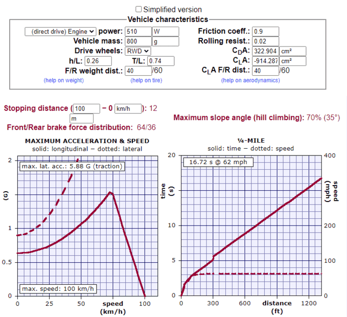

This results in the following inputs into the acceleration sim:
Vehicle characteristics input form: power 510 W, vehicle mass 800 g, friction coefficient 0.9, rolling resistance 0.02, drive wheels RWD, h/L 0.26, T/L 0.74, F/R weight distribution 50/50, CdA 161.45 cm², ClA -457.14 cm², ClA F/R distribution 40/60.
(I also added stuff like aero balance, weight distribution etc., though those are approximations)
This gives me the following results:
Four-panel vehicle performance chart: maximum acceleration and speed (longitudinal solid, lateral dotted), quarter-mile time and speed versus distance, speed versus time to 100 km/h, and vertical force on front and rear axles versus speed.
What's interesting (but maybe totally irrelevant) is that for this set of values I get a very smooth quarter mile curve which isn't a given for all values, eg. those you picked iirc.
No, I thought you had only one.
The equation used throughout the website[1] is ##F_{lift} = 0.5\rho C_L Av^2##. (It is defined here)
You have to be careful with aerodynamic coefficients as they can be based on very subjective data. The important relation is:
$$C_L \propto \frac{F_{lift}}{A_{ref}\rho v^2}$$
Where ##A_{ref}## is some reference area that represents the size of the object. The frontal area is commonly used in the automobile industry, but sometimes, some people use the bottom view area of the car, as they find it more representative. Since both areas are usually proportional, it doesn't change anything in the end, but the value of ##C_L## will not be the same in both cases. This is why it is better to know ##C_L A## as a whole rather than just ##C_L## and try to guess which area was used as a reference.
Similarly, it is usual to use the ##0.5## factor, because it comes from the dynamic pressure definition ##\frac{F}{A} = 0.5\rho v^2##. But if you don't use it to define ##C_L##, it is OK as long as everybody knows when using it for calculations. Otherwise, it will be off by a factor of 2. You don't seem to use it in your calculations: Are you sure how your ##C_L## was defined?
As for the numbers I used for your aerodynamic coefficients, I based them on this:
giulioooooh said:
Fdownforce(x)=0.073*(1.225kg/m³)*6245cm²*(x*m/s)²+(9.81N/kg)*400g
Fdrag(x)=0.5*0.052*(1.225kg/m³)*6245cm²*(x*m/s)²
If I understood your equations correctly, for ##C_D A##, I used ##0.052 \times 6245 \text{ cm²}## and I use ##-0.5 \times 0.073 \times 6245 \text{ cm²}## for ##C_L A##. I wanted to compensate for the lack of 0.5 in your equation, but I realize that I made a mistake and I should have used ##-2 \times 0.073 \times 6245 \text{ cm²}##. But maybe your equation is wrong and your ##C_L## value is correct to be used as is in the program. You'll have to check this out.

I used the equations that I uploaded some shots of which I calculated w my CAS. This is the right side of the equations I uploaded, unfortunately I don't have enough screen real estate to show them completely:
Two CAS worksheet rows: V = x * 1.225 kg/m^3 * 6245 cm^2 * (15 m/s)^2 * x, giving x = 0.073201 in the upper row and x = 0.025853 in the lower row.
So yeah, I took both equations without the 0.5 factor as I thought they would cancel out either way. Multiplied by 6245cm² I got the values I put into vehicle characteristics earlier (which seem to be incorrect).
If I add that .5 factor into both equations as is shown on the Acceleration page I get the following values (entered into Vehicle characteristics):
Screenshot of a vehicle performance simulator showing vehicle characteristics, a stopping distance readout, and two graphs: maximum acceleration and speed, and a quarter-mile time and speed plot.
This seems logical and all, the only thing bothering me right now is that weird jagged section in the quarter mile graph I didn't get with the earlier values.
Vehicle characteristics form: Wheel dropdown, power 255 W, vehicle mass 800 g, RWD drive wheels, h/L 0.18, T/L 0.53, F/R weight distribution 50/50, friction coefficient 0.9, rolling resistance 0.013, CdA 324.7 cm², CLA -227.9 cm², CLA F/R distribution 33/67.
Though, when quadrupled, the value you entered up here for CLA lines up with the new values I got, which in turn lines up with what you said here:
jack action said:
f I understood your equations correctly, for CDA, I used ²0.052×6245 cm² and I use ²−0.5×0.073×6245 cm² for CLA. I wanted to compensate for the lack of 0.5 in your equation, but I realize that I made a mistake and I should have used ²−2×0.073×6245 cm².
So yeah, I think the values I got now are pretty much correct.Anyways, I'm going to go to bed now and think about this for a while. Thanks so much for helping me, and I got to say that your website is a great resource for aero amateurs. The only thing about it I'd change is how hard it is to find. The best website of the world isn't going to help anyone if you can only find it on the 8th page of google, yknow? Nevertheless, great work and keep going strong!
