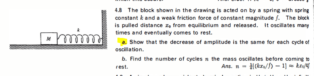

- Homework Statement
- below
- Relevant Equations
- na

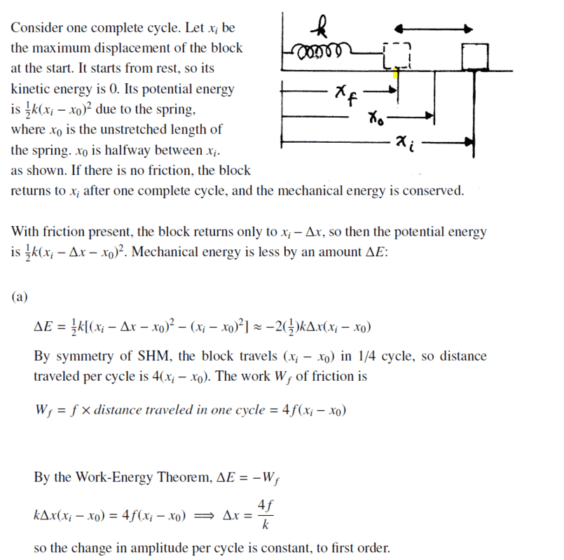

Solution in 2ed manual:

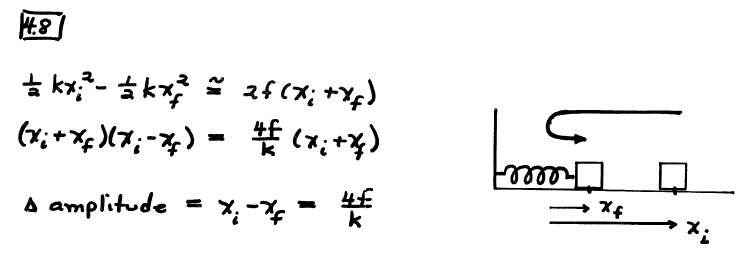

Solution in 1ed manual:
Could someone explain why the work done by friction is multiplied by 2? I get that the distance traveled by the block in one cycle is greater than ##x_f+x_i##, but why is the coefficient two?
