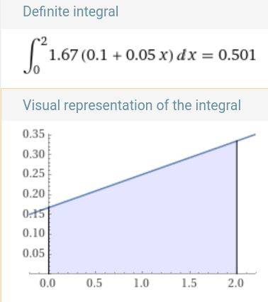

By my math it should be -0.501 J, is that incorrect?

You mean " by Wolfram Alpha's math" its ##-0.501 \rm{J}##. Wolframs math looks correct to me also...

Thanks, it's frustrating trying to learn when you can't check your work against the answer key.

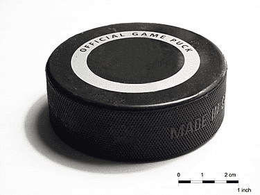

I had to look it up. Google "how heavy is a hockey puck".
https://en.wikipedia.org/wiki/Hockey_puck said:
Ice hockey requires a hard disk of vulcanized rubber. A standard ice hockey puck is black, 1 inch (25 mm) thick, 3 inches (76 mm) in diameter, and weighs between 5.5 and 6 ounces (156 and 170 g);[6] some pucks are heavier or lighter than standard (see below). Pucks are often marked with silkscreened team or league logos on one or both faces.[6] Pucks are frozen before the game to reduce bouncing during play.[6]
