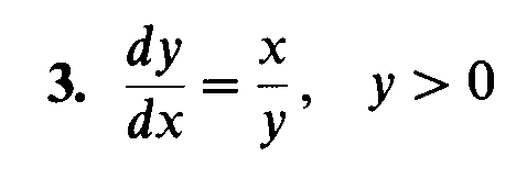

why do i need the information that y>0?
$$\frac{dy}{dx}=f(x)~\rightarrow~dy=f(x)dx~\rightarrow~y=\int f(x)dx$$
$$\frac{dy}{dx}=\frac{x}{y}~\rightarrow~\int y~dy=\int x~dx~\rightarrow~y^2=x^2~\rightarrow~y=x$$
I square root y2 and if y<0 it works also

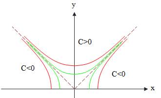

If ##C > 0## the functions ##y = \sqrt{x^2+C}## and ##y = + (x+C)## or ##y = -(x+C)## are different; their graphs do not even look the same. One of them is differentiable everywhere, while the other two are not.
