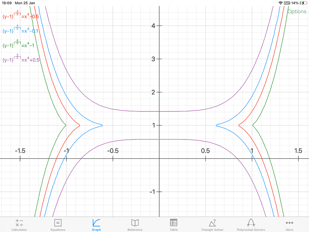

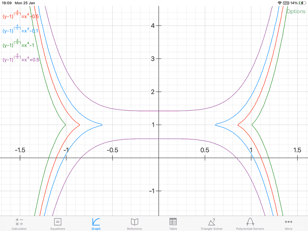

Possibly the way the question was posed may slightly hide something from you. You get two solutions from the given initial condition. but from any other initial condition you only get one. One of the solutions (y = 1) does not involve any arbitrary constant, and is a single curve, not a family, so it is called a 'singular solution'. If you have graphed the function you will have seen that it is the locus of cusps. That is just one type of singular solution. I give some example curves below, A denser set would be more illustrative but I don't have the technology for it. Also cusps not well rendered.
Not all cusp loci of de's are solutions but this one is. You can see that the cusp locus does not go through all the solutions. And that they have two branches.
(A more familiar type of singular solution, the only one I dabbled with before now, are envelopes, which I think are always solutions of the d.e.). I might go further into this if there is any interest shown, perhaps the OP can add considerations or question, but it is open to anyone.

I'm still really new to this, have only started learning about it three weeks ago actually! But all of that is really interesting, so far I've just been learning the basics so I'm not too familiar with the term envelopes actually, would love to gain more insight though.
