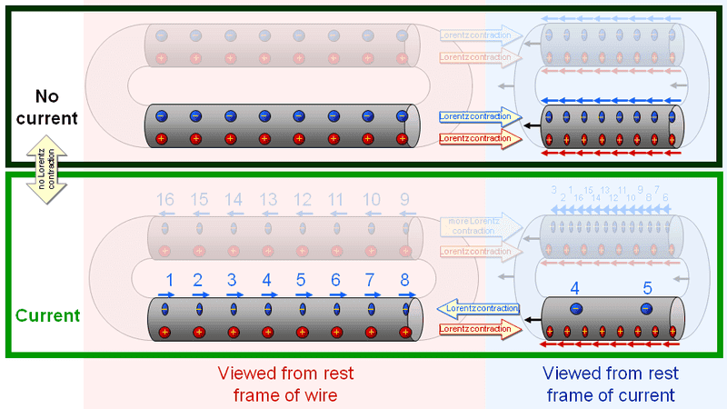

Here is a good explanation by DrGreg:
https://www.physicsforums.com/threads/explanation-of-em-fields-using-sr.714635/page-2#post-4528480
