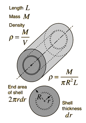

Why is the end area of shell [tex]2\pi rdr[/tex]?
Thanks in advance. :rolleyes:

It's the area expressed in differential form. To acquire the correct formula, you need to calculate the integral with respect to r.
Intuitively, the differential form means this : to describe an infinitesimal small area, take the circumference 2 times pi times r and make it a bit thicker, expressed by the dr. Integrating over r means that you sum up the area of all this different, very thin, circumferences to get the total circular area.
marlon
Oh, I got that! Thank you marlon! I am giving my first steps over integration. And congratulations for the award!
