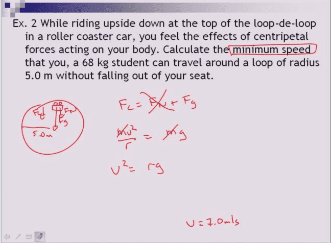

Roller Coaster--Circular Motion
I have a few questions about the way this question was done. The instructor said: "The minimum speed will be at the point where the seat doesn't have to exert any force on you".
This doesn't make sense to me. Why will the minimum speed be at this point?
That defines the point where you just start to lose contact with the seat--in other words, it's the point where you start to fall out of the seat.
You do realize that the faster you go, the more you are pushed against the seat and thus the greater the normal force?

This is where I am mixed up.
At the top of the loop, the forces acting on the the person will be fg and fn and they are in the same direction (downwards)
Since the centripetal force is the sum of these then: Fc=Fg+FN
If both forces are acting downwards, what is pushing you into your seat? Why won't you fall out?
Thanks (I'm new at this :) )
True. But realize that while fg is fixed (it's your weight), fn is not. fn depends on the speed.
OK. Note that Fn and Fc will change with the speed.
Realize that you are moving fast. Without the seat there, you'd go shooting off into the air. You need forces pushing you down, not up. (You can think of it as your inertia pushing you into the seat.)
Fn is a measure of how hard the seat has to push down on you to keep you from going straight. If you go too slow, the seat won't have to push you at all--you'll start falling.
