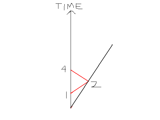

Try drawing a space-time diagram, like the one below. Yes, there is a certain amount of "math" involved in doing it, but maybe if you do that we can follow what the heck you're talking about.
Here's the explanation of the diagram below, and how it illustrates that GR implies time dilation.
If you've ever listened to a horn on a moving vehicle, you are probably familiar with the "doppler shift" effect. The sound emitted from a moving vehicle is higher in pitch when it approaches, and lower when it leaves.
In relativity, doppler shift is replaced with redshift and blueshift. If a transmitter transmits signals at a regular 1 second interval, they will be received at higher frequencies, and hence intervals shorter than 1 second by an approaching observer. Similarly, a receeding observer will receive the signals at intervals of longer than 1 second. This is not yet "time dilation", this is what is directly observed, including propagation delays.
Because the speed of light is constant for all observers, in relativity the doppler shift factor depends only on the relative velocity. This fact alone is sufficient to derive all the equations of SR. This is done in, for instance, "Relativity and common sense" by Bondi, the approach of using doppler shifts in this manner is usually called K-calculus.
In the diagram below, time points upwards, and space is horizontal. The stationary observer S (stationary only in the sense that the diagram is drawn from his perspective) is represented by a vertical black line - it's vertical because his space position never changes. The moving observer is represented by a slanting black line. Red lines are light signals.
The transmitter emits a light signal (red line) at 1 second after the origin - the origin is the point where the two observers are at the same point at the same time. Because of the constancy of the doppler shift, this will be recived at some time multiple of the transmitting time. In this diagram, this multiplying factor, bondi's "k" factor, is 2. So the signal is transmitted at t=1, and received at t'=2, where the prime mark indicates that that's the time assigned to the event by the moving observer M.
It's a bit confusing to have a couple of different "times" on the diagram, but any point on the diagram will have one set of coordinates (t,x) in the stationary frame S, and another ,possibly different set of corrdinates (t', x') in the moving frame M.
In this example, we have only one value in the moving frame, this is the value of T' for the moving observer which is equal to 2 at the event marked '2' on the diagram. All other times on the diagram occur in the non-moving frame.
Now, suppose the moving observer sends a signal back (or the original signal reflects) at his time T'=2. Because the doppler shift factor depends only on velocity, and because all motion is relative, we can apply the same formula to conclude that the signal will arive back at the first observer at T=4.
These points are labelled 1,2, and 4 on the diagram.
By the constancy of the speed of light, the stationary observer can conclude that the event that occurred at T'=2, the reflection of the signal, had a time T (a T-coordinate) of (1+4)/2 = 2.5. This is true because the light, emitted at 1 second, must have a travel time of 1.5 seconds, arriving at the moving obserevr M at 1+1.5 = 2.5 seconds, and returning at 2.5 + 1.5 = 4 seconds.
This illustrates that T is not equal to T' for the event labelled '2', the reception of the signal emitted at the event labelled '1'.
Further, it illustrates that T' < T, showing 'time dilation'.
