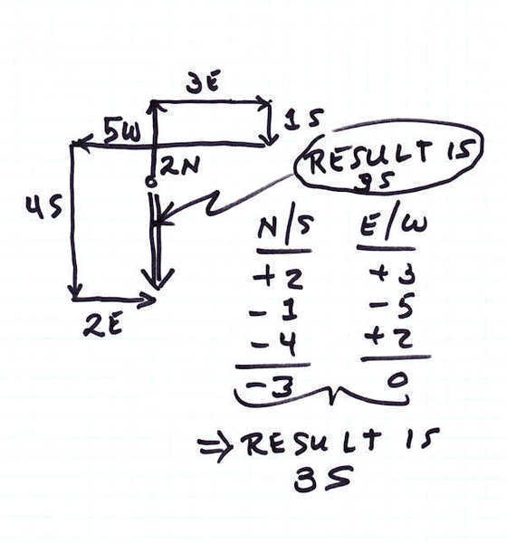

on a trip to the supermarket, you walk 2 blocks N, 3 blocks E, 1 block S, 5 blocks W, 4 blocks S, then 2 blocks E. what is the shortest way home?

Could be I'm not getting what it is that you are having difficulty with, but here's my take. The trig is just to get you the XY sides of each vector. In your example, you already HAVE those, so you don't need any trig:
All vector additions are just additions of all the X movements and all the Y movements to total up to one final vector.
