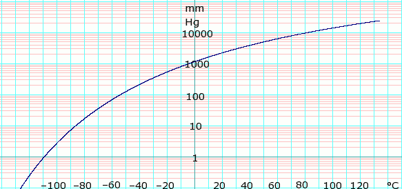

The flash point seems to be a function of vapor pressure. The intermolecular interactions of isobutane are weaker than those of n-butane because it's a compact molecule and doesn't stack as neatly with itself. This makes it more volatile and gives it a higher vapor pressure.
Here's the n-butane vapor pressure curve-
and the isobutane curve-
