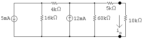

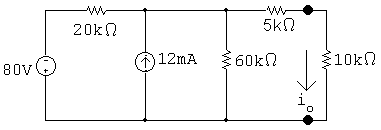

I am a bit confused on why they can just randomly short the 4kΩ resistor, as you can see from the first pic to the second pic.
Circuit schematic with a 5mA current source and 16kΩ resistor in parallel, a 4kΩ resistor in series, a 12mA current source with 60kΩ resistor, a 5kΩ resistor, and a 10kΩ resistor with current i0 labeled downward.
Circuit schematic with an 80V voltage source and 20kΩ resistor in series on the left, a 12mA current source with a 60kΩ resistor in parallel in the middle, and a 5kΩ resistor in series with a 10kΩ resistor on the right, with current io marked downward through the 10kΩ resistor.

They didn't just short the 4K resistor. The 5 ma current source, the 16K resistor and the 4 k resistor was made into a norton (or is it thevinin) equivalent.
