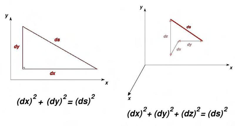

lengths of the other two sides. One can generalize the Pythagorean theorem to three dimensions as well:
c2= a2 + b2 + c2
see image 2.0 below

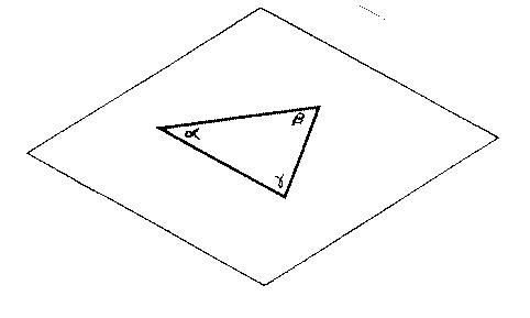

On a plane, a "geodesic" is a straight line(shortest distance between two points). If a triangle is constructed on a flat 2 dimensional plane by connecting three points with geodesics. The curvature can be represented in 2D, if you establish each angle of a equilateral triangle with
[itex]\alpha[/itex],[itex]\beta[/itex],[itex]\gamma[/itex] for a flat geometry this follows the relation
[itex]\alpha[/itex]+[itex]\beta[/itex]+[itex]\gamma[/itex]=[itex]\pi[/itex].
image 1.0
image 2.0 reference (3)
On a plane, (shown above) we can set up a cartesian coordinate system, and assign to every point a coordinate (x; y). On a plane, the distance ds between points (dx and dy) is given by the relation
[itex]d{s^2}=d{x^2}+d{y^2}[/itex]

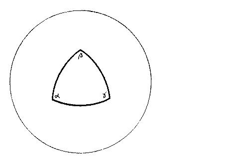

If a triangle is constructed on the surface of the sphere by connecting the angles will obey the relation
[itex]\alpha[/itex]+[itex]\beta[/itex]+[itex]\gamma[/itex]=[itex]\pi+{AR^2}[/itex]
image 1.1
where A is the area of the triangle, and R is the radius of the sphere. All spaces in which
[itex]\alpha[/itex]+[itex]\beta[/itex]+[itex]\gamma[/itex]>[itex]\pi[/itex] are called positively curved" spaces. It is a space where the curvature is homogeneous and isotropic; no matter where you draw a triangle on the surface of a sphere, or how you orient it, it must always satisfy the above equation.

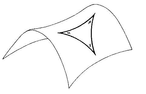

"An example of a negatively curved two-dimensional space is the hyperboloid, or saddle-shape. A surface of constant negative curvature. The saddle-shape has constant curvature only in the central region, near the "seat" of the saddle."(1) Consider a two-dimensional surface of constant negative curvature, with radius of curvature R. If a triangle is constructed on this surface by connecting three points with geodesics, the angles at its vertices [itex]\alpha[/itex]
[itex]\beta[/itex],[itex]\gamma[/itex] obey the relation [itex]\alpha[/itex]+[itex]\beta[/itex]+[itex]\gamma[/itex]=[itex]\pi-{AR^2}[/itex].
[itex]{ds^2} = {dr^2} + {R^2} {sinH^2}(r/R)d\theta^2[/itex]
image 1.2
A negative curvature is an open topography
