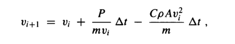

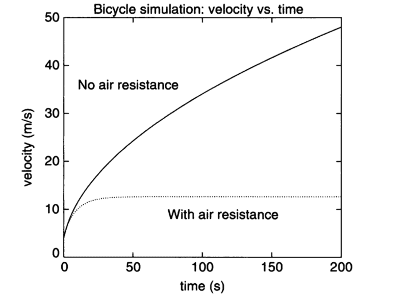

I need to write a program in Matlab that accomplishes this graph:
I keep getting an error on Line31 Column 161 about unexpected parenthesis. They look balanced to me. If I take one away from either side, I get an error that I am short a parenthesis.
I also need to change the colors of the lines and position the titles in the proper place by the lines.

What is the . doing in this expression?
Code:
(mass.)
Also, it would have been helpful to know which line was line 31 ...
Edit: Furthermore, you cannot let v(i) depend on v(i), you should let it depend on v(i-1) ...

I'm sorry, I was thinking that the code would have to be pasted in MatLab. Line 31 is
Code:
velocityWithDrag(i) = velocityWithDrag(i) + ((power.*dt)./(mass.*velocityWithDrag(i)))-((dragCoefficient.*airDensity.*surfaceArea.*velocityWithDrag(i)^2)/(mass.));
I don't know what the period does. I just saw people doing that in similar codes and thought it had to be done.
and for the edit. Oh, the i+1 is missing from my expression. let me fix that.
edit: I took away the period behind mass in that line, and I got this error:
Index exceeds matrix dimensions.
Error in Bicycle (line 31)
velocityWithDrag(i+1) = velocityWithDrag(i) +
((power.*dt)./(mass.*velocityWithDrag(i)))-((dragCoefficient.*airDensity.*surfaceArea.*velocityWithDrag(i)^2)/(mass));
I think I get what you meant. let me change i+1 to i, and i to i-1.

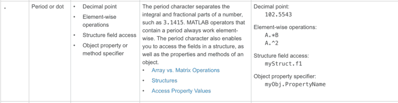

Orodruin said:
This should be a strong warning sign to you. If you do not know what something does in a code that you need to write, you should check it out and try to understand it.
See https://se.mathworks.com/help/matlab/matlab_prog/matlab-operators-and-special-characters.html for more information.
I don't know what that means.
I get the decimal point. I just figured it did something like force the program to give approximate answers rather than exact. like my calculator.

In which capacity are you using the dot? What is the reason for writing it down?
because the person who wrote the first bit of the code that I am recycling used it.

I've corrected the i+1 and i's, and took the dot off of mass. the code is working. But now I need to make it look exactly like the plot. I changed my headings. changed the velocity with drag plot to a dotted line. changed the colors to black.
how do I change the number of ticks. so that the y-axis goes in steps of 10 rather than 5? a google search provides what appears to be a variety of ways. but I can't make sense of them.
edit: I think it works if I change Xscale to Xtick
Honestly, it appears as if whoever did the code you were given does not know what they are doing either.
Matlab is largely written for the explicit purpose of manipulating matrices (that is where the "mat" in the name comes from). Used this way, the dot in front of an operator signifies that the operation should be performed element by element, i.e., * is matrix multiplication whereas .* is multiplication element by element. In this case, your entire expression handles numbers, i.e., 1x1 matrices, and it therefore does not matter if you have the dots or not.
That makes a lot of sense. It gives me the ability to ask an "educated" question (I hope). Why did the dot on the mass at the end of that formula mess it up? but not any of the other dots?
Because that dot was not part of an element-wise operator. It was just out of place and not in accordance to Matlab syntax.
