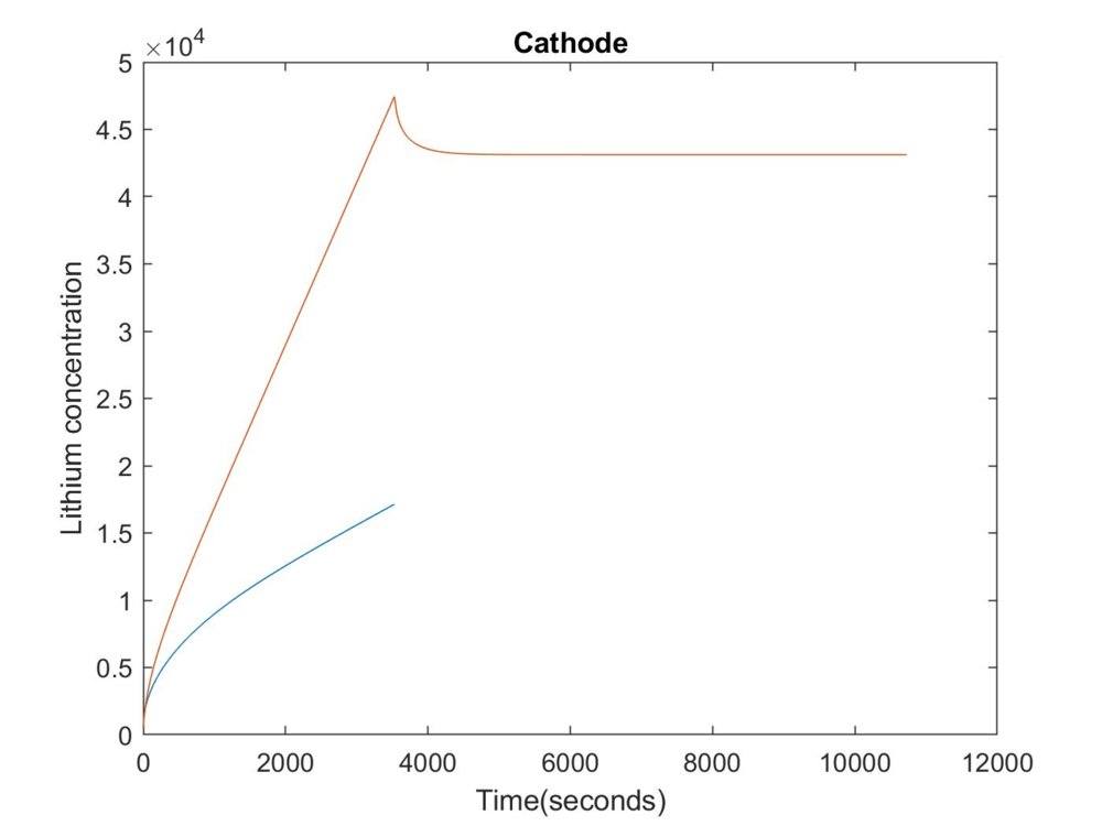

I think it was my boundary conditions that were causing the problems and I wanted to make sure that I could code something up that worked, and I think I managed to. I did something reasonable and the code worked nicely and there was nothing blowing up, so I am going to compare the results from my code and yours to see if they get the right thing and if they are then that's good. The next thing to consider is the speed of execution. I'll be calling this routine potentially thousands of times and I want it to be as fast as possible.
I'm also interested as to why my other code isn't working.
I coded up my original method with the new way of doing the boundary conditions and I got something which both ran and gave reasonable results and then I wrote it up as a function and tested it against a fancy adaptive timestep code and I give the comparison on my code (in blue) and the fancy one in red. I'm not sure what is gong on, it could be a question of units.

I'm harping back on this again. I take the equation:
[tex]\frac{\partial u}{\partial t}=\frac{D}{r^{2}}\frac{\partial}{\partial r}\left(r^{2}\frac{\partial u}{\partial r}\right)[/tex]
With boundary conditions:
[tex] \frac{\partial u}{\partial r}\Bigg|_{r=0}=0\qquad D\frac{\partial u}{\partial r}\Bigg|_{r=1}=q(t)[/tex]
I take the original equation, multiply it through by [itex]r^{2}[/itex] and integrate from 0 to 1 to obtain the following:
[tex]\frac{d}{dt}\int_{0}^{1}r^{2}u(t,r)dr=q(t)[/tex]
Now my code should be able to reproduce this little fact. If I take [itex]q(t)[/itex] constant for example I can get an exact equation for the average value as being linearly increasing (if [itex]q(t)[/itex] is positive). Sadly I don't seem to get this. If my algorithm is of the form:
[tex]A[\mathbf{u}]^{i+1}=B[\mathbf{u}]^{i}+\mathbf{c}[/tex] then I can directly check this property by doing:
[tex]\mathbf{r}^{2}\star A[\mathbf{u}]^{i+1}=\mathbf{r}^{2}\star B[\mathbf{u}]^{i}+\mathbf{r}^{2}\star\mathbf{c}[/tex]
where [itex]\star[/itex] denotes pointwise multiplication and boldface denotes a vector, I get something attaached.
