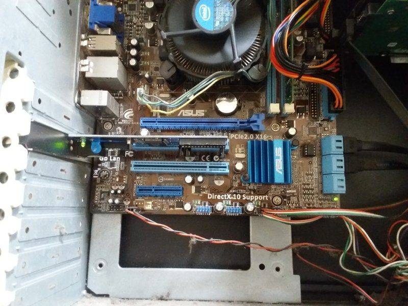

There must be people here who remember me discussing about lightning affecting my neighbour's appliances. Now it seems that I am also a victim.
But in my case, the problem is different: the lightning has come up through the cable of broadband connected to my PC, thereby burning the LAN card.
Now, I opened up the cabinet, and the LAN card is connected to the motherboard, as shown below:
Photo of a desktop motherboard inside a PC case with a red arrow pointing to the LAN port on the rear I/O panel; the board is labelled P7H55-M LE and shows an Intel CPU cooler and PCIe x16 slots.
It is evident that I won't be able to change the LAN card without desoldering the one fixed to the motherboard, and I'm in no mood to play with the motherboard.
I was searching for LAN card online, and found a few, like https://www.amazon.com/gp/product/B00E9R7FNK/?tag=pfamazon01-20. I want to fit it in one of these ports:
Photo of a desktop motherboard inside a PC case, labelled P7H55-M LX, with red arrows pointing to two empty PCI Express x1 slots below the blue PCIe x16 slot.
The question is, will that work? I have a 100Mbps broadband connection.

russ_watters said:
Looks like that card should work, but you should check your motherboard spec and the lan card specs to ensure they are exactly compatible.
How do I find the motherboard specs? I know it's made by Asus.
See the label P7H55-M-LX I think that is an Asus model number.
As per the motherboard specs and the specs of the LAN card, it should work on my windows 7.
CWatters said:
You might need to disable the onboard LAN controller incase enough of it is working to cause a conflict. Google found...https://www.manualslib.com/manual/438745/Asus-P7h55-M-Lx-Usb3.html?page=37
Scroll to bottom of that page.
I found a short video showing the bios settings. I found how to disable the inbuilt LAN card.
The card is no longer being detected, and is not showing up under network adapters list. But I'll still be on the safe side and disable it before loading the new one.
Do I have to change anything on bios after plugging in the card?
Usually this Windows will automatically find drivers although they may not be the latest. I would allow windows time to do its thing when you power it up. Once connected to the internet perhaps run windows update to see if there is a newer driver.
OK, thank you for the help.

Bought the lan card and fixed it on the slot.
Photo inside an open desktop computer showing an ASUS motherboard with a newly installed network card in a PCIe slot, labelled Gb LAN, with an Intel CPU cooler and RAM slots visible above.
It's working properly. There was a problem with the screws. The CPU cabinet is about 18 years old, and if I tried to tightly screw the card, it was coming off. Anyways, I fixed it somehow with a single screw.
I thank all who have helped in choosing the accessory, and given further installation instructions, especially @CWatters.
