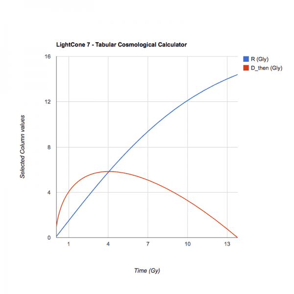

About the picture, in the year 4 billion (or thereabouts) the distance growth rate was 1/58 of a percent per million years. That is to say that a distance of 5.8 billion lightyears was growing at exactly the speed of light. So a "snail-like" flash of light that was crawling towards us and was then 5.8 billion LY from us makes zero progress. The tear-shape lightcone profile is FLAT at that point.
Mwave, I think you probably understand what's being discussed here very well but just to give a concrete example, if you take a picture of a galaxy today and it is what astronomers call redshift z = 1.6, that means that the wavelengths of the hot hydrogen and sodium and stuff have all been stretched by a factor of S = 2.6 (for historical accident reasons, the "redshift" is always one less than the actual stretch factor.)
And that wavelength enlargement, or stretch, factor means that the light was emitted in year 4 billion (because 2.6 is the factor by which distances have been enlarged since then).
And the nice thing, I think, is that when it was emitted the light made zero progress for a while because distance growth exactly canceled the speed towards us of the light. The light just hung there at a distance of 5.8 billion LY, not gaining ground, just holding its own. And then very gradually the percentage rate which was 1/58 % per million years, declined slightly, to like 1/59% per million years, and then 1/60% per million years. And the light began to inch ahead.
You can see in the picture how the Hubble radius, starting at year 4 billion is 5.8 billion LY and then increases, e.g. to 5.9 billion LY and 6.0 billion LY and so on. It is a convenient way to keep track of the declining distance growth rate. It is not a physical distance itself but a tool for keeping track of the growth rate.

Some readers may be interested in how you get the Lightcone tabulator to plot graphs (like above) instead of making tables. First, for example, go to Lightcone, set upper and lower S factors at 40 and 1, and the number of steps to 50. That will cover a convenient span of time from around year 67 million up to the present. with 50 steps the resolution of the table will be fine enough that you actually see the Hubble radius and Dthen cross at 5.8 billion LY in year 4 billion.
When you generate the table you will be generating the same numbers that are plotted in that figure with the two curves, a few posts back. Then there's a way to eliminate the distracting other numbers that we're not interested in, at the moment. But for starters, setting steps=50 and S to run from 40 down to 1 here is what you get.
Look down the T column to about 12 rows from the bottom where it says year 4.0233 billion (i.e. approximately year 4 billion):
[tex]{\scriptsize\begin{array}{|c|c|c|c|c|c|}\hline R_{0} (Gly) & R_{\infty} (Gly) & S_{eq} & H_{0} & \Omega_\Lambda & \Omega_m\\ \hline 14.4&17.3&3400&67.9&0.693&0.307\\ \hline \end{array}}[/tex] [tex]{\scriptsize\begin{array}{|r|r|r|r|r|r|r|r|r|r|r|r|r|r|r|r|} \hline a=1/S&S&T (Gy)&R (Gly)&D_{now} (Gly)&D_{then}(Gly)&D_{hor}(Gly)&V_{now} (c)&V_{then} (c) \\ \hline 0.025&40.000&0.0674&0.1021&38.875&0.972&1.384&2.70&9.52\\ \hline 0.027&37.155&0.0754&0.1141&38.568&1.038&1.482&2.68&9.10\\ \hline 0.029&34.513&0.0843&0.1275&38.249&1.108&1.586&2.66&8.69\\ \hline 0.031&32.058&0.0943&0.1425&37.918&1.183&1.697&2.63&8.30\\ \hline 0.034&29.778&0.1054&0.1592&37.575&1.262&1.815&2.61&7.93\\ \hline 0.036&27.660&0.1178&0.1779&37.219&1.346&1.942&2.58&7.56\\ \hline 0.039&25.693&0.1317&0.1988&36.849&1.434&2.076&2.56&7.22\\ \hline 0.042&23.866&0.1472&0.2221&36.465&1.528&2.219&2.53&6.88\\ \hline 0.045&22.168&0.1645&0.2481&36.066&1.627&2.371&2.50&6.56\\ \hline 0.049&20.592&0.1839&0.2772&35.653&1.731&2.532&2.48&6.25\\ \hline 0.052&19.127&0.2055&0.3097&35.224&1.842&2.704&2.45&5.95\\ \hline 0.056&17.767&0.2297&0.3460&34.779&1.958&2.885&2.42&5.66\\ \hline 0.061&16.503&0.2567&0.3866&34.317&2.079&3.078&2.38&5.38\\ \hline 0.065&15.329&0.2868&0.4319&33.837&2.207&3.283&2.35&5.11\\ \hline 0.070&14.239&0.3205&0.4824&33.339&2.341&3.499&2.32&4.85\\ \hline 0.076&13.226&0.3582&0.5389&32.823&2.482&3.728&2.28&4.60\\ \hline 0.081&12.286&0.4002&0.6020&32.287&2.628&3.970&2.24&4.37\\ \hline 0.088&11.412&0.4472&0.6724&31.732&2.781&4.225&2.20&4.14\\ \hline 0.094&10.600&0.4996&0.7511&31.155&2.939&4.494&2.16&3.91\\ \hline 0.102&9.846&0.5582&0.8389&30.557&3.103&4.778&2.12&3.70\\ \hline 0.109&9.146&0.6237&0.9369&29.936&3.273&5.076&2.08&3.49\\ \hline 0.118&8.496&0.6967&1.0462&29.292&3.448&5.389&2.03&3.30\\ \hline 0.127&7.891&0.7783&1.1682&28.624&3.627&5.717&1.99&3.10\\ \hline 0.136&7.330&0.8695&1.3043&27.931&3.810&6.060&1.94&2.92\\ \hline 0.147&6.809&0.9712&1.4560&27.213&3.997&6.418&1.89&2.75\\ \hline 0.158&6.325&1.0847&1.6251&26.468&4.185&6.792&1.84&2.58\\ \hline 0.170&5.875&1.2115&1.8134&25.696&4.374&7.180&1.78&2.41\\ \hline 0.183&5.457&1.3528&2.0229&24.896&4.562&7.584&1.73&2.26\\ \hline 0.197&5.069&1.5105&2.2560&24.067&4.748&8.001&1.67&2.10\\ \hline 0.212&4.708&1.6863&2.5148&23.209&4.929&8.431&1.61&1.96\\ \hline 0.229&4.373&1.8823&2.8019&22.320&5.103&8.873&1.55&1.82\\ \hline 0.246&4.062&2.1006&3.1198&21.400&5.268&9.326&1.49&1.69\\ \hline 0.265&3.773&2.3435&3.4711&20.450&5.419&9.789&1.42&1.56\\ \hline 0.285&3.505&2.6136&3.8583&19.468&5.554&10.258&1.35&1.44\\ \hline 0.307&3.256&2.9137&4.2836&18.454&5.668&10.732&1.28&1.32\\ \hline 0.331&3.024&3.2467&4.7491&17.410&5.757&11.208&1.21&1.21\\ \hline 0.356&2.809&3.6155&5.2562&16.335&5.815&11.684&1.13&1.11\\ \hline 0.383&2.609&4.0233&5.8054&15.232&5.837&12.156&1.06&1.01\\ \hline 0.413&2.424&4.4731&6.3963&14.101&5.818&12.620&0.98&0.91\\ \hline 0.444&2.251&4.9681&7.0270&12.945&5.750&13.073&0.90&0.82\\ \hline 0.478&2.091&5.5109&7.6938&11.768&5.627&13.511&0.82&0.73\\ \hline 0.515&1.943&6.1040&8.3911&10.573&5.443&13.930&0.73&0.65\\ \hline 0.554&1.804&6.7496&9.1115&9.364&5.190&14.327&0.65&0.57\\ \hline 0.597&1.676&7.4488&9.8452&8.149&4.862&14.699&0.57&0.49\\ \hline 0.642&1.557&8.2024&10.5811&6.932&4.452&15.042&0.48&0.42\\ \hline 0.692&1.446&9.0099&11.3071&5.720&3.955&15.356&0.40&0.35\\ \hline 0.744&1.343&9.8702&12.0108&4.521&3.366&15.640&0.31&0.28\\ \hline 0.801&1.248&10.7813&12.6807&3.342&2.678&15.892&0.23&0.21\\ \hline 0.863&1.159&11.7403&13.3067&2.189&1.889&16.114&0.15&0.14\\ \hline 0.929&1.077&12.7436&13.8814&1.068&0.992&16.307&0.07&0.07\\ \hline 1.000&1.000&13.7872&14.3999&0.000&0.000&16.472&0.00&0.00\\ \hline \end{array}}[/tex]
You will see that the Hubble radius R and the light's distance from us Dthen are both about 5.8 billion LY. That is where the curves cross in the plotted figure.
You can click on "column definition and selection" to open the column menu to deselect the columns you don't want.
You can for example get rid of scale factor a, and stretch S, and keep only time T and Hubble radius R and Dthen

Right, I wasn't sure for which situation was the snail on the rubber band sheet a valid analogy, since the rubber band sheet stretched by a certain distance at every step, and not a certain percentage. Anyways, certainly, if we had a closed universe without dark energy, any place in the universe can be reached within finite time since the universe will go to a big crunch - worst case scenario you just wait around for the big crunch to happen and for the distant galaxy to come to you. For an open universe, it seems intuitively clear, and mathematically clear, that the total proper distance traveled diverges to infinity as your proper time (or coordinate time) diverges to infinity IF you didn't lose energy to the expansion. If the energy lost due to expansion were taken into account (which I had not considered before Oro brought it up), I am no longer sure that even the proper distance traveled will diverge. The pertinent question to this thread; however, is not the total proper distance traveled, but is in what scenarios will your co-moving distance traveled (coordinate distance traveled in the FLRW coordinates) diverge to infinity? This is the measure by which you might reach a distant co-moving observer.
Mwave, suppose you are a regular PF member who visits Cosmo forum sporadically, how would you react if I just show you this plot and ask
"In year 10 billion, what was the percentage growth rate of distances (going by this figure)?"
Do you think it's clear enough how to read a percent growth rate from the figure like that? It is the same figure with two curves I included a few posts back. Does it need more explanation or is it clear enough already? I'd like it accessible to fairly wide audience of people interested enough in cosmology to dip into threads here.

I think I would need some further explanation. Which curve, the red or the blue, corresponds to proper distance traveled, and which curve corresponds to comoving distance traveled? Is the red the comoving distance traveled and the Blue the proper distance? Or neither? Does the red-line curving backwards means this light ray will never reach us if it originated from more than 5.8 Gly away?
Mwave thanks for the response. I have been wanting someone to discuss this picture with to see what is or is not understood and what kind/amount of explanation is needed!
To answer one of your questions, the RED curve, labeled Dthen, is the proper distance the light was from us at some moment (indicated by position on the time axis. This is for a flash of light that we receive today. You can see that if the light was emitted in year 1 billion it will initially be dragged back, away from us (the distance from us increases, the red curve rises). But after year 4 billion, you can see that the light begins to make headway towards us, and its proper distance from us decreases. And the red curve slopes down.
Are you OK with this?
The blue curve is labeled R, like the red, the units are billions of LY. The blue curve is the HUBBLE RADIUS, it is a way of keeping track of the distance growth RATE.
It is defined as the size of distance which, at that moment in time, is growing at speed c. The other largescale distances are growing proportionately. One which is twice R would be growing at speed 2c.
What I think is the important thing to learn and understand here is how the Hubble radius at some particular moment (e.g. year 10 billion) encodes the percentage growth rate. Once the coin drops and you understand, you will be able to simply look at the figure, notice that at that moment, year 10 billion, the Hubble radius is 12 billion LY, and then immediately convert that mentally into the percentage growth rate that prevailed at that time.
It's actually really simple: in a million years a distance that size, growing that rate, would increase by a million LY. So what percentage is that?
what is the fraction 1 million/12 billion ? Well it is 1/12 times 1/1000. And that is the fraction we call 1/120 percent. So the our sample distance of 12 billion LY is growing 1/120 percent per million years.
And all the other large-scale distances (outside of gravitationally bound systems are growing at essentially that same percentage rate. (Ignoring minor local motions of stuff. this is the basic expansion rate as of year 10 billion.)
It is a simple rule of thumb and it applies to our own epoch as well. Today the Hubble radius is estimated to be 14.4 billion LY. So what is the percentage growth rate of cosmic distances?
Hint: it is somewhat LESS than 1/120 percent per million years. The percentage distance growth rate has been declining, as the Hubble radius (shown as the blue curve in the figure) has been increasing.
I'm a bit confused by this calculation. Where did you get 1 million LY from and the 1 million years? How do I read that off the graph? Wouldn't the growth rate actually be something like the derivative of the Blue curve?
EDIT: Nevermind, I got it. You are basically saying since that Hubble radius is the radius at which things are "moving away at the speed of light" from us, then the distance is growing at 1 million light years / million years. I think if you used 1 light year/year it would have been a bit more obvious haha.
thanks for the comment! I may be able to work a reference to 1 LY per Y into a future explanation. You understand why one would also want to think of the percentage growth on a per million year basis. Because current percent rates are already pretty small even on that basis, like 1/144 % per million years . Don't want to boggle the reader (and have to use extra words) by changing to extreme smallness like "1/144 millionths of a percent" per year. Hard to imagine such a small fraction.
But one could make the offhand remark that the speed of light is 1 LY per Y or equivalently 106 LY per 106 Y, and then go from there.
BTW how easy is it to judge other Hubble radius sizes just looking at the blue curve? For example roughly what was R in year 1 billion? To me it looks like R was about 1.5 billion LY. At year 1 billion the blue curve is not quite halfway up from zero to 4, so it is less than 2. But more than 1. Judging by eye it looks like 1.5 to me.
If that's how you judge it too, then that tells you what the percentage rate of distance growth was, around year 1 billion.
(We could always refer to the table if we needed an exact number, but IMO it's nice to be able to read a simple curve plot figure visually like that.)

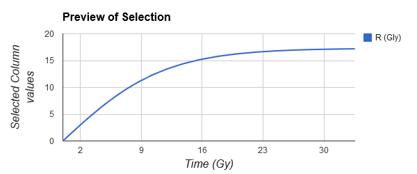

Certainly this growth rate can be related to the Hubble constant right? After all, the Hubble constant can also be expressed as a frequency. 70km/s/Mpc converts to what in %/million years? (I'm lazy and Wolfram won't do this automatically).
Visually the curve is not too difficult to read. But at 1 Billion years, I can only tell it's between 1 and 2, not so much that it's 1.5 Gly.
It's been a while since I've done cosmology (several years), and so this stuff is slowly coming back to me lol.
Another thought: as the blue curve is always increasing, then this "%/million years" growth rate will always be decreasing right? How does this mesh with the fact that Hubble's constant is a constant? Am I confusing myself again? Was the Hubble constant much larger in the past?
Yes. The "constant" in the "Hubble constant" is a misnomer based on that Hubble's original relationship was linear (he did not look far away enough). The Hubble constant at a given time is ##\dot a/a## and thus will change with time.
But in order to coincide with this %/million year growth rate, it must be actually strictly decreasing whenever the blue curve is increasing. In the past, the Hubble constant must have been quite a bit larger than it is now. Is that true? I guess if the "hubble time is t=1/H" then yes...H must have been a lot larger back when t was a lot smaller...
Correct. If you look at inflation, the Hubble constant was was huge. The only way of having a constant Hubble constant (or Hubble parameter, which is less of a misnomer) is to have exponential expansion (##\dot a = Ha## with ##H## constant gives ##a \propto \exp(Ht)##).
