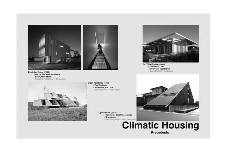

I am working on an independent study that involves housing typologies and their adaptation to climatic conditions. I am looking at row housing and how their facades may become more adaptable and responsive to changes during storm conditions. My site is beach front and prone to hurricane/ cyclone storm activities. I am wondering if anyone may have any insight as to what forms the facade may begin to take. For example, I have considered altering the beach facing facade from a 90 degree (vertical) wall, to a facade that is tilting it at a more subtle angle such as 30 degrees from the horizon so that it can better address strong winds. I have also considered a double facade that is separate from interior walls. This most exterior wall may have "punch outs" to reduce the surface area and reduce wind loads. I appreciate any and all commentary.

Sorry to get back so late. I have included diagrams and plans of my current design.
Shown are some precedents I have looked at and my initial design phases from concluding ideas. I have also contemplated ideas from some readings on wind tunnel testing of various pitched roofs that 30° is the maximum pitch desirable to minimize wind loads on the windward side of the roof. I have then concluded I wish to morph the roof and exterior wall into one form (a tilted facade). I then chose to pop out voids in the tilted facade to act as decks or lounging areas to escape to the outdoors while still maintaining a level of privacy. The decks are then operable to pivot along a point and become protection from debris. I have also elevated the structure to account for flooding and this elevated space on street level also becomes a breezeway to allow for wind to pass under it. (I have wondered if uplift would be an issue in this design step?) All in all the idea of my design is to elevate the living space, allow for wind to pass over and under (as these are row houses and the sides are negligible except for those on the end, which I am still working on how this will workout). Also the decking and other platforms would form a "testudo" form that protects from winds and debris.

here are some elevations, plans, and axons on how they perform

I am beginning to look into these as how they may become beneficial towards my process. Thanks for the advice. The only concern I have is that these seem to be on trees and grow tall whereas my site would mandate a low structure (45' at best in height). However, I think if I spend some time exploring these more in depth I can begin to understand what it is about them (other than just their shape) that allows for a better wind adaptability. Perhaps their texture is something to consider? Again thanks for the precedent, I will look more into this.
