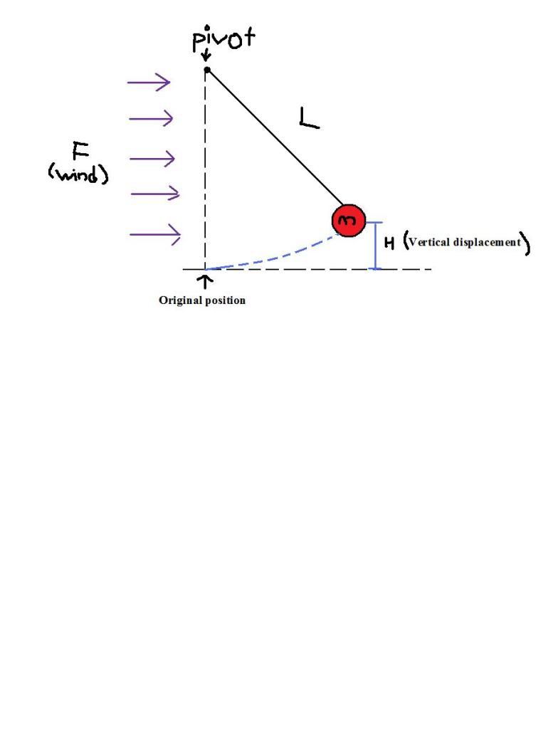

Ball with mass m is connected by a strong string of length L to a pivot point and held in place in a vertical position. A wind exerting constant force of magnitude F is blowing from left to right. If the ball is released from rest, show that the maximum height H it reaches (the vertical displacement), as measured from its initial height, is:
H = 2L / 1 + (mg/F)2
It may sound like I did not attempt it, but I honestly did and am not sure where to begin. =\
At some angle with the vertical, the force due to wind, the tension and the weight of the ball all balance each other. Find out the angle from this equilibrium condition. Then finding the height is all trigonometry.

Yes, I'm sure. It says it right out of the textbook.
I've posted a picture of the problem in this link:
http://i1097.photobucket.com/albums/g349/Physics_/Pivot.jpg
Lol...there was no use of posting the diagram.
I tried to convert my answer into that expression but failed.
Even ehild sir says that my answer is correct. So most probably your text's answer is wrong.
Try using my hint which I gave in first post and solve.

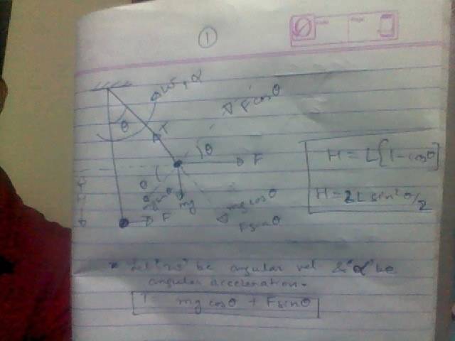

The solution of this problem using classical mechanics is :
  • Handwritten derivation on lined paper: w²/g = (2/mL)[F sinθ + mg(cosθ − 1)]; at max height, w = 0 giving (2F/mL)[sinθ − (mg/F)(1 − cosθ)] = 0; then sinθ = (mg/F)·2sin²(θ/2), and a further step with cos(θ/2) and sin(θ/2).
  • Handwritten derivation on lined paper: torque equation (F sin θ − mg sin θ)L = Iα, leading to α expressed over mL, then ω dω/dθ substitution and integration from 0 to θ of (F sin θ − mg sin θ) dθ over mL.
  • Handwritten notes on lined paper showing a pendulum diagram with angle theta, tension T, applied force F and mg, plus equations h = L(1 - cos θ) and h = 2L sin²(α/2), and a boxed result mg cos θ + F sin θ.
